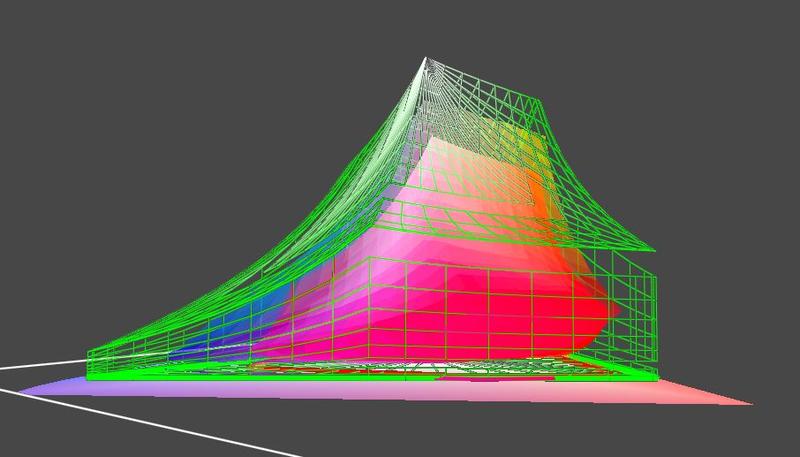

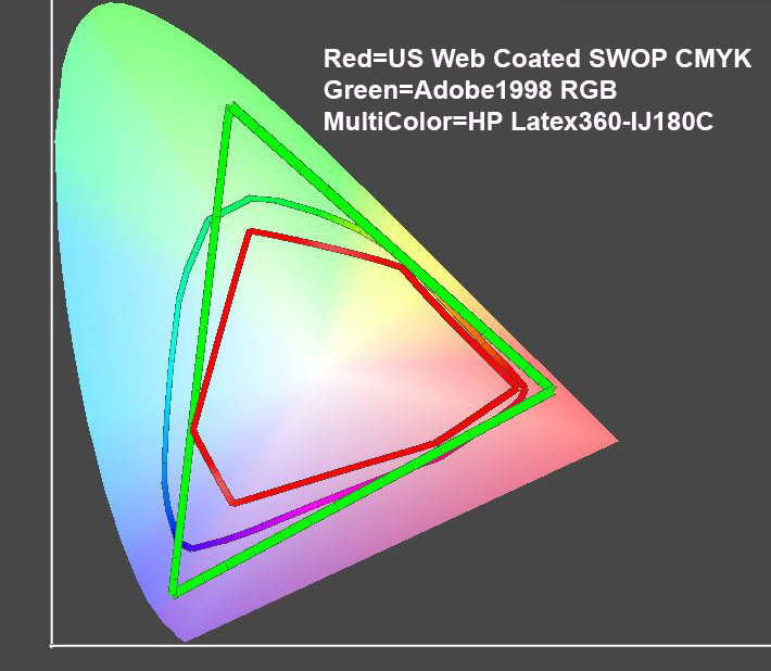

In the plot below, I am comparing the gamuts of:
Adobe 1998 - RGB
US Web Coated SWOP v2
An HP Latex 360 printer, printing onto IJ180C cast vinyl (a custom output profile)
As you can see, the printer's profile dwarfs that of SWOP, and is mostly contained inside of Adobe 1998 (you can better see this in the 3D plot comparison). Designing in CMYK SWOP will restrict the colors in the file to those inside of the red boundary, and if the color is not in the file, then the printer should not be printing it.
