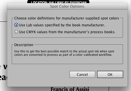

I thought the default was to display spot colors as LaB... or at least mine is.
