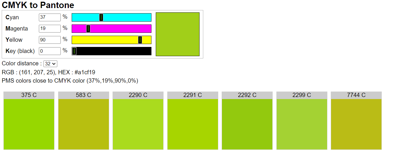

I apologize if this is the wrong place to post. I tried converting a CMYK color to PMS today for something I need to have printed and ended up with a virus on my computer. My CMYK colors are C:37 M:19 Y:90 K:0. Can anyone tell me what the PMS color would be? TIA

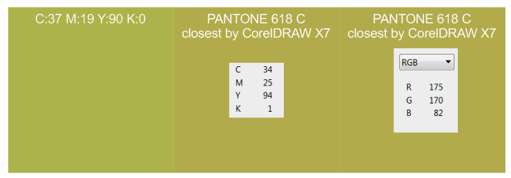

Just to add some confusion, PMS 2304C is Illustrator's best match (color build is C:32 M:6 Y: 77 K:12 - so you're trading mostly magenta for black)

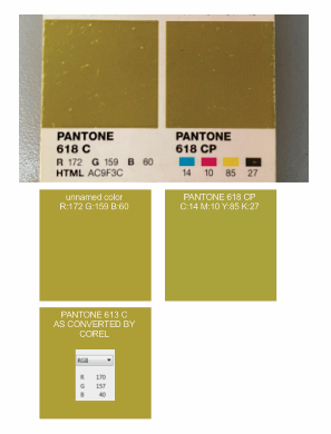

+the build listed above for PMS618 is incorrect, actual build for that is C:19 M:16 Y:91 K:28 (per the PMS color bridge book)
I don't put a lot of stock in those online converters, you're going to get a different answer everywhere you go... If you have a swatch book handy, I would look at the suggestions made in this thread and just pick one/let the client pick one.

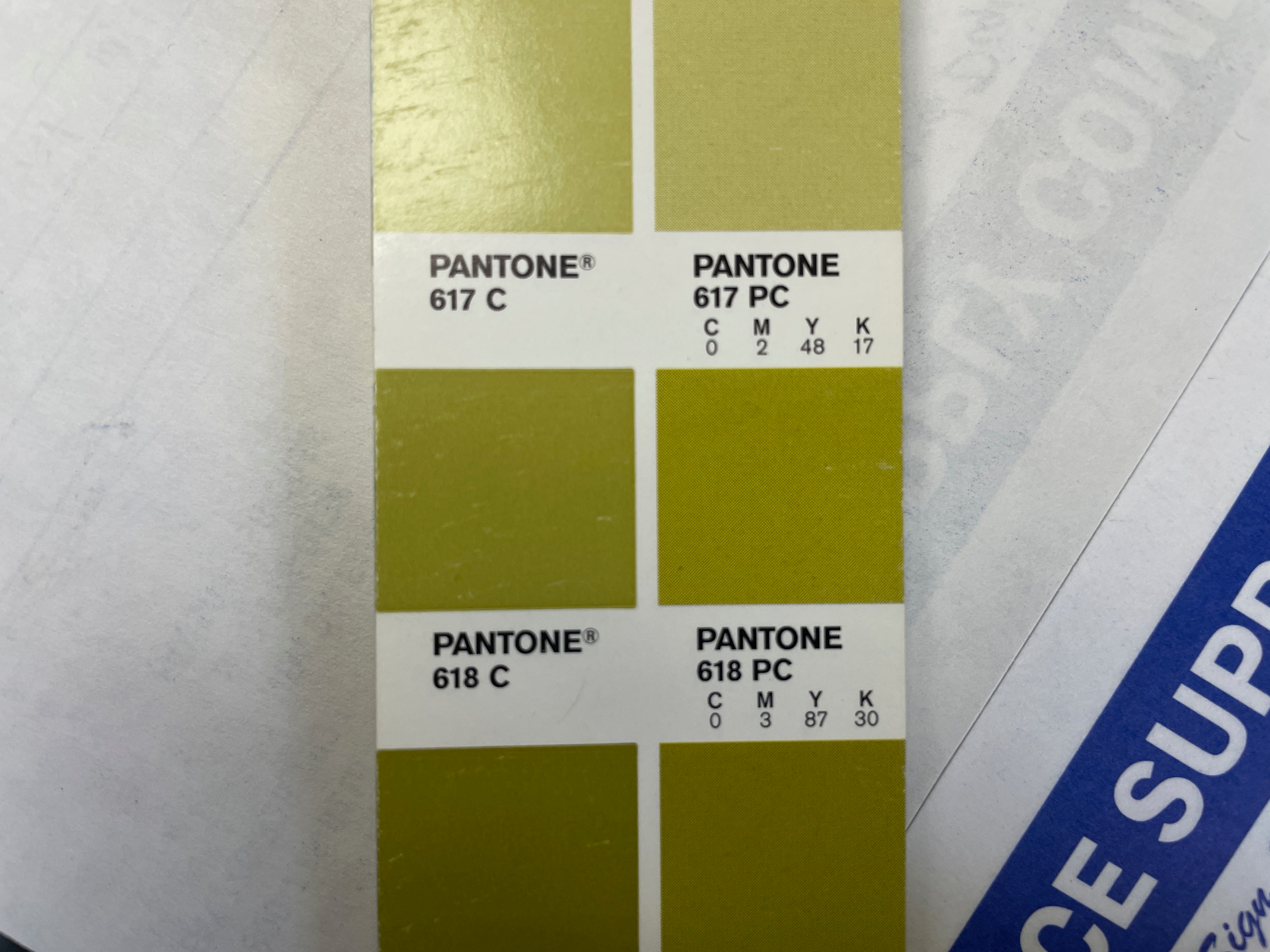

The books I just ordered for Pantone Bridge have the UC after the number for the uncoated book and CP for the coated book.
Not sure what the letters stand for
