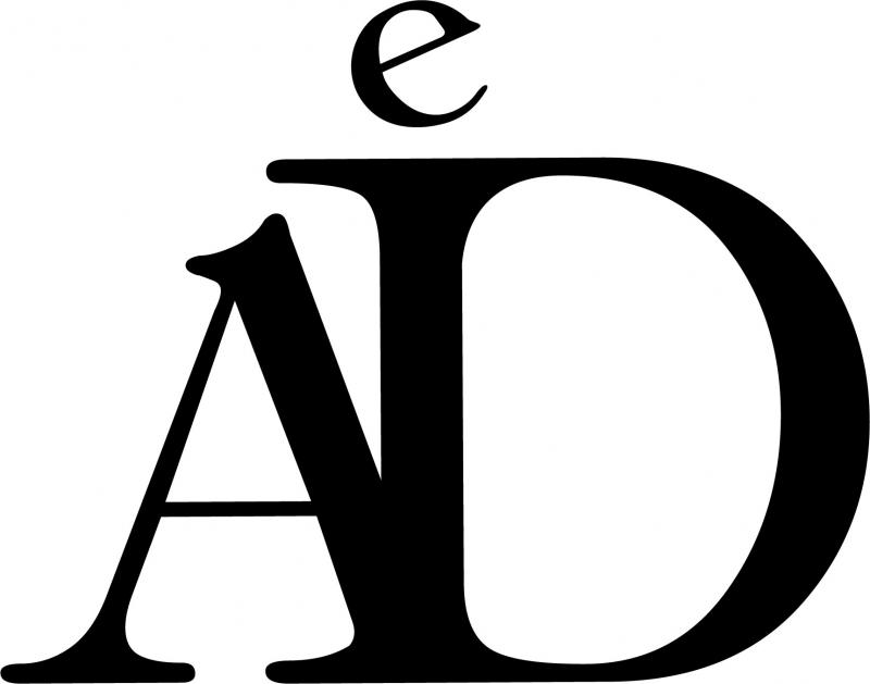

diamondavenue
Hopefully this works.
Stamp

How thick is the material?
If you have a vector file I'll help you out.

dman thanks for the offer I am talking to one guy locally right now, if he falls through I will definitely contact you, and thanks for the attachment info also. I am thinking I would like it about 2" thick what material would you suggest, I thought wood to be durable and keep costs low but also heard plastic may be a better option. appreciate everyones help.

Wood should work for a temporary application. I guess you plan on using multiple pieces of thinner material like 1/2" thick? Make all the cuts, attach them together until you get 2" thick?
Are the letters going to be pressed into the snow? or is the stamp going to make the letters raised up out of the snow?
I guess I'm asking which part is the negative space in your image?

I was thinking it would have to be multiple pieces attached together and then onto a back plate with handles. letters are going to be pressed into the snow. thats the reason I thought wood would be best is to get enough pressure and not worry about breakage. i figure i could always paint it for longevity.
