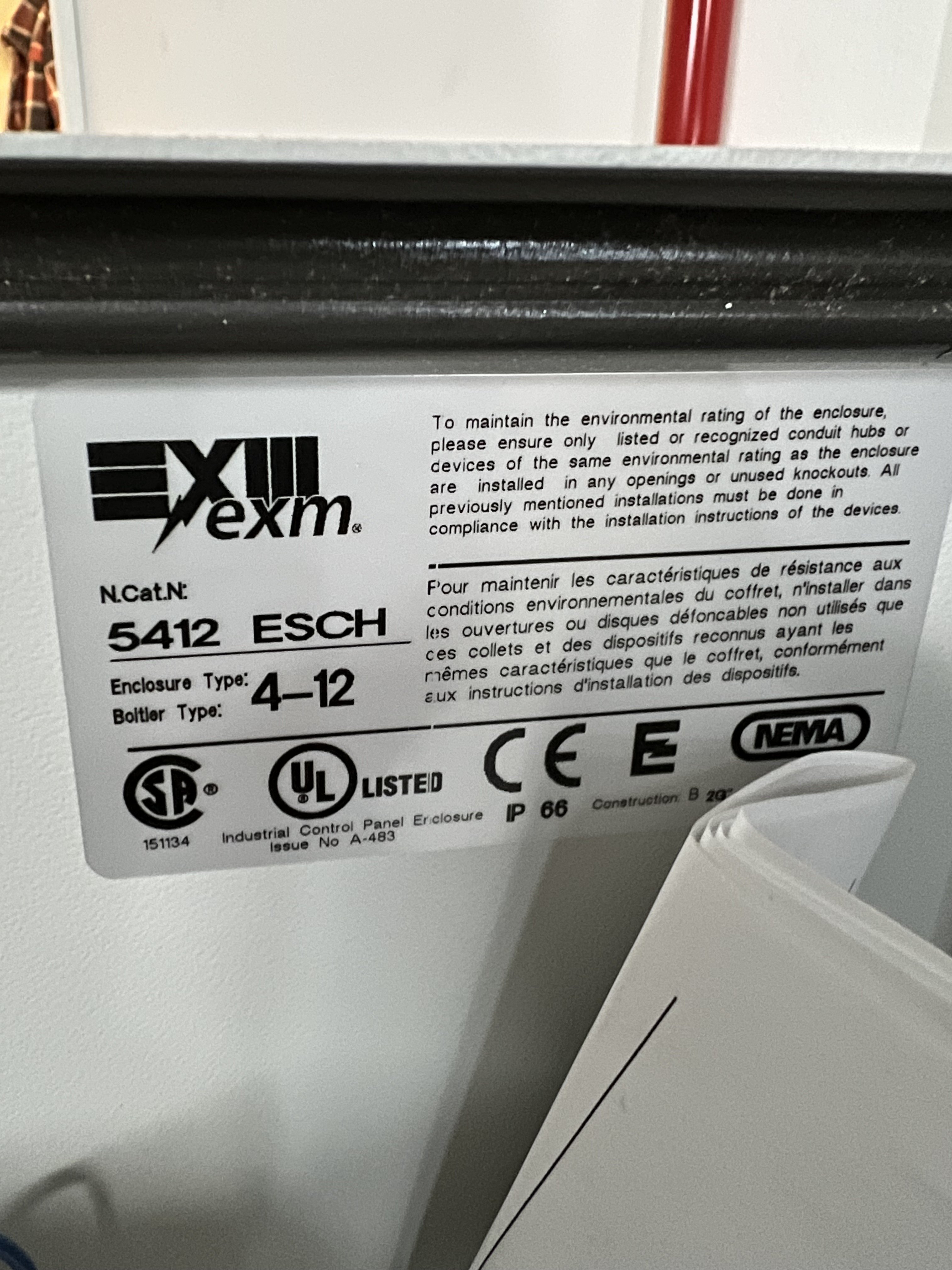

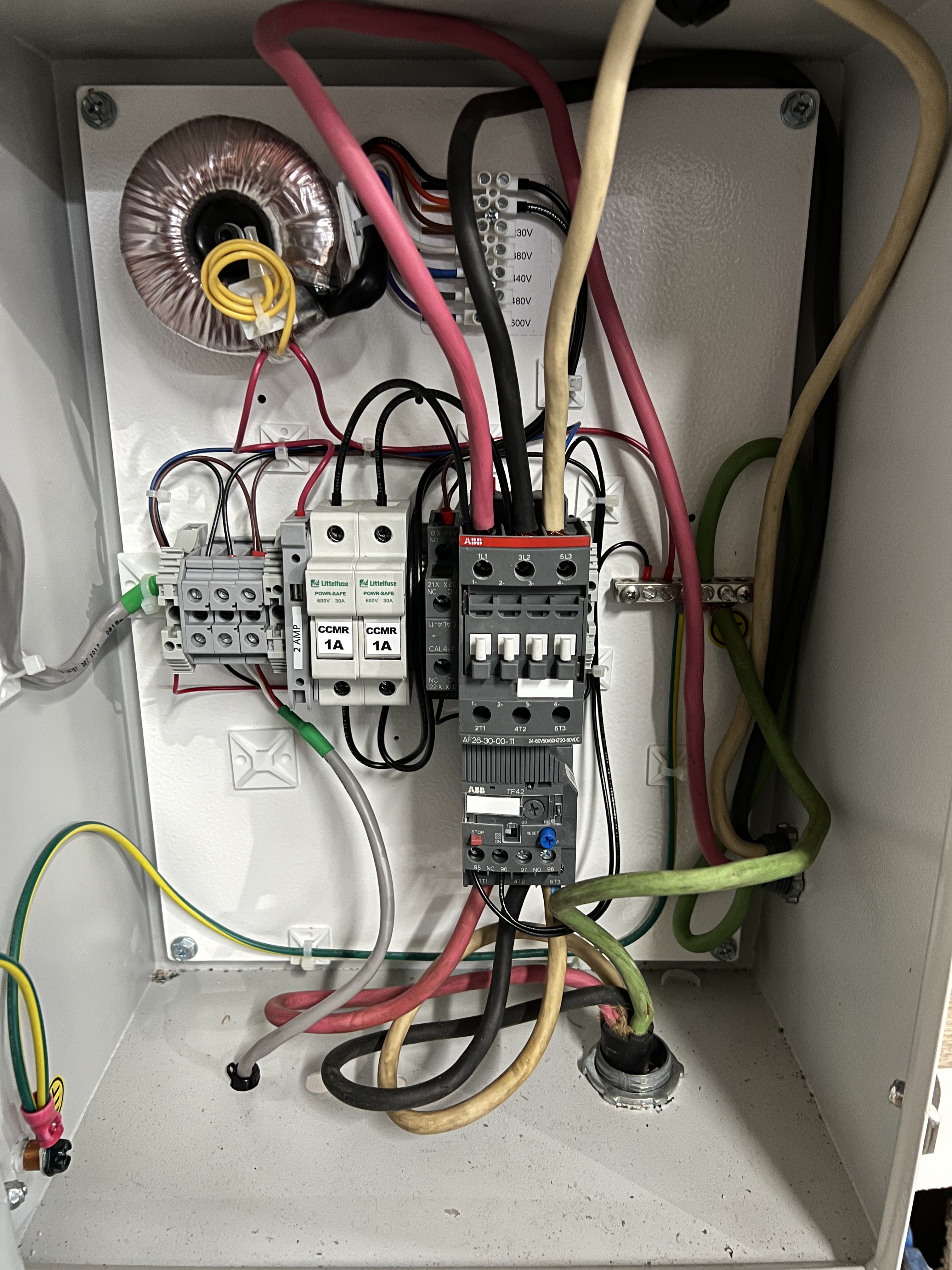

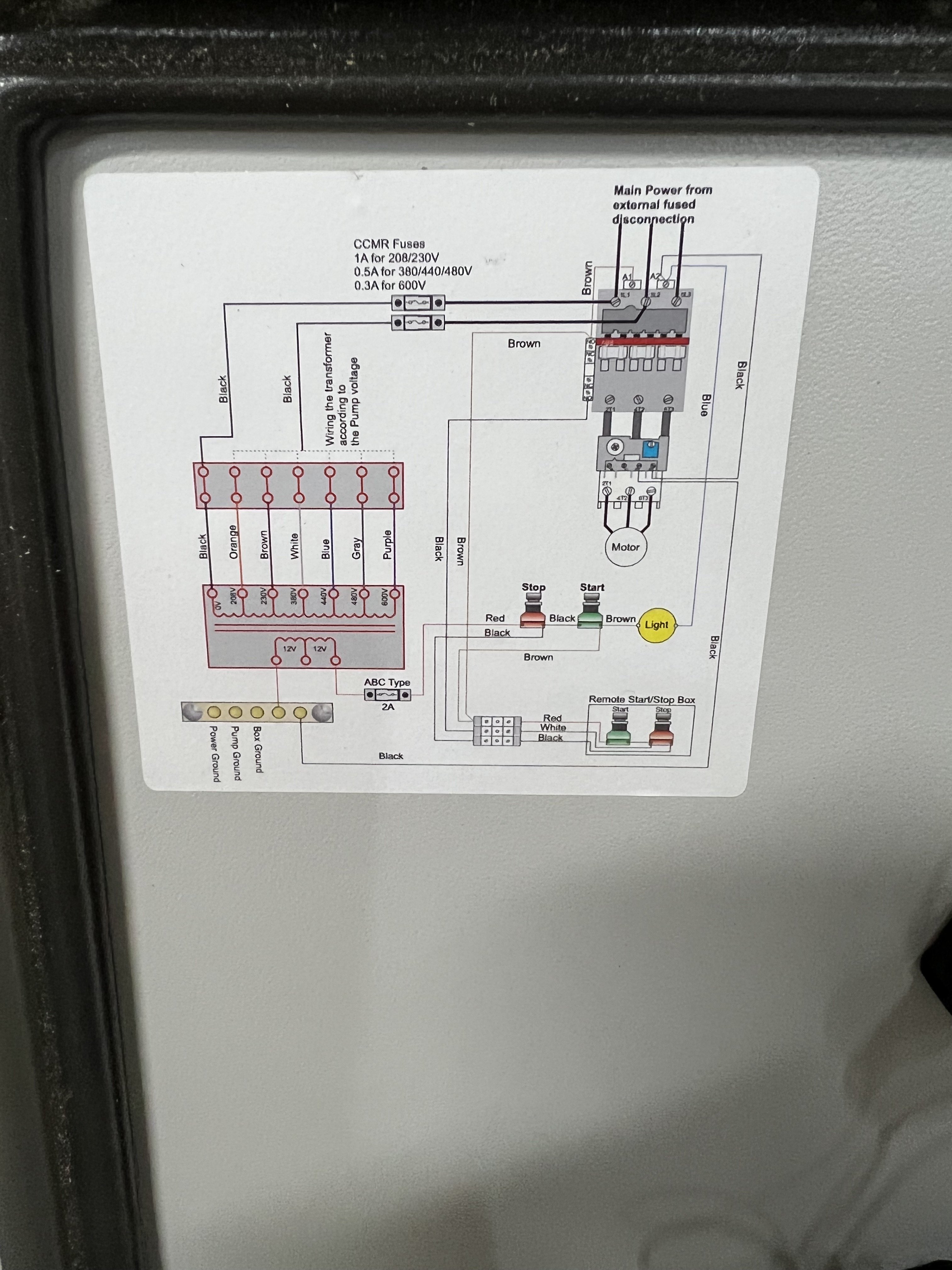

I have to purchase a switch for the pump. Would yiuvhappen to know anything about good place to get that?
johnnysigns
Our Busch pump came with the magnetic shutoff box, but I can see if it has any specs on it. An electrician should be able to help, but I'll check if there's any info they sent me or on their box.
johnnysigns
