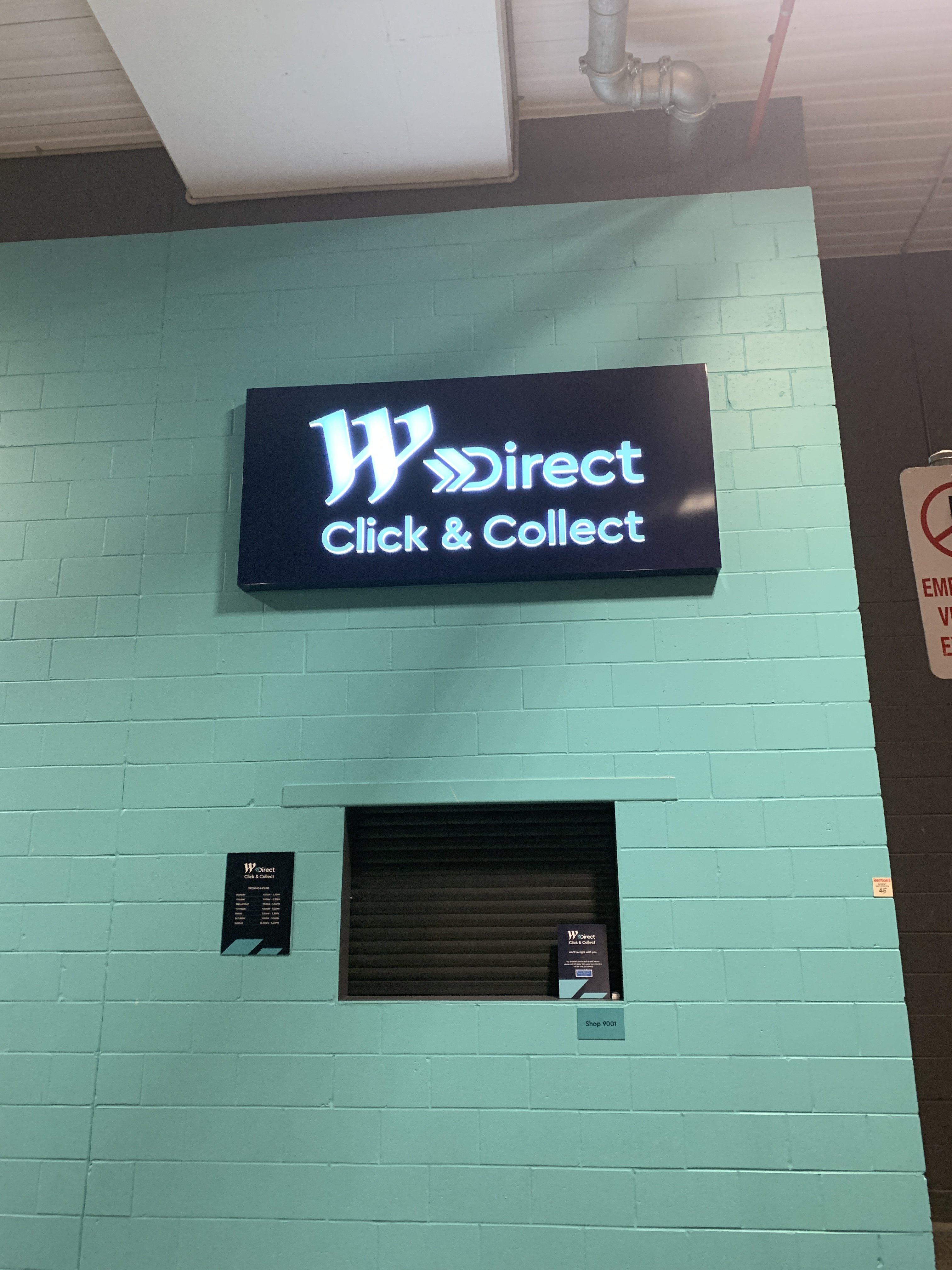

So this is the kind of box. With back lit 20mm acrylic lettering poking through routed Alupanel.
Then colour printed on translucent media stuck on front of lettering.
We can ship out for parts but feel it’s time to stay in house for speed and efficiency.
