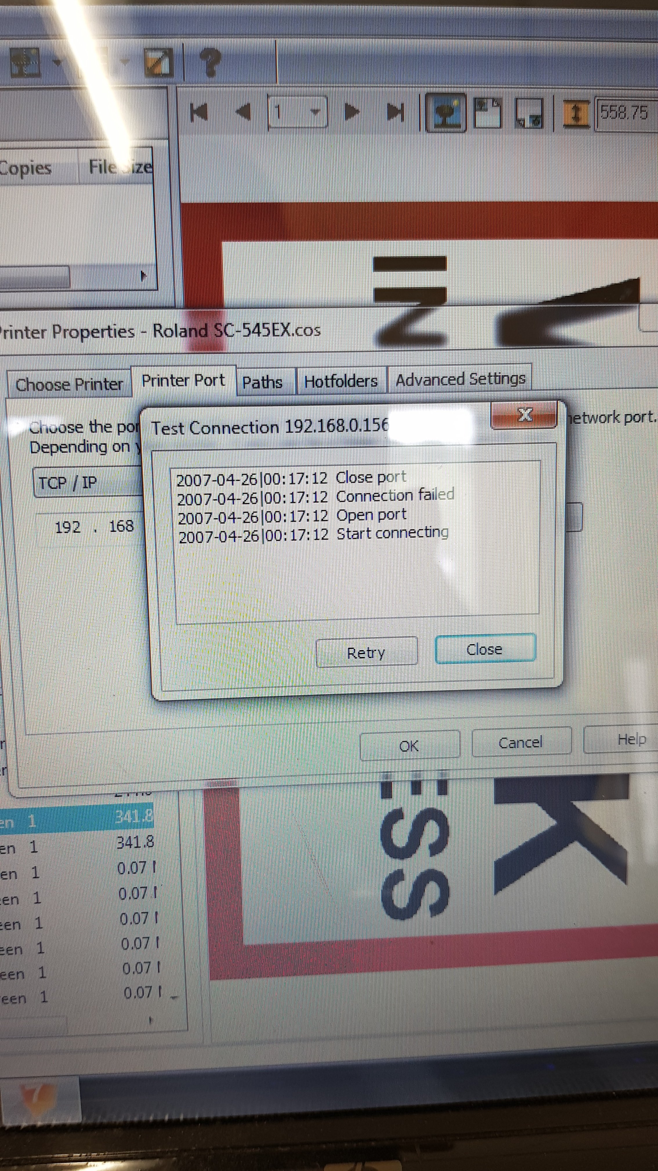

I'm running colargate PS7 with my Roland SC-545 printer.
All of a sudden I can't seem to print files, there seems to be a connection issue.
When I send a file to print it stays printing at 0% and the busy light on my Roland doesn't flash like usual when receiving a file so I know there is an issue with connectivity.

Connected via ip port.
It was working fine yesterday but now it's not.
Happened before and I restarted the laptop and Roland machine and it fixed the issue but I've tried it multiple times and no help.
rory_thomas
Photo attached of test connection

AF
Turn off DHCP, manually enter IP addresses of all network equipment. Restart any hubs or switches.
