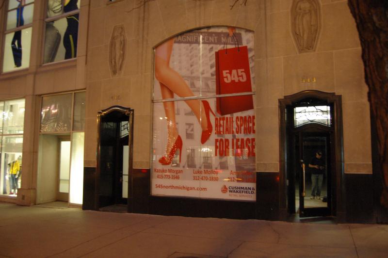

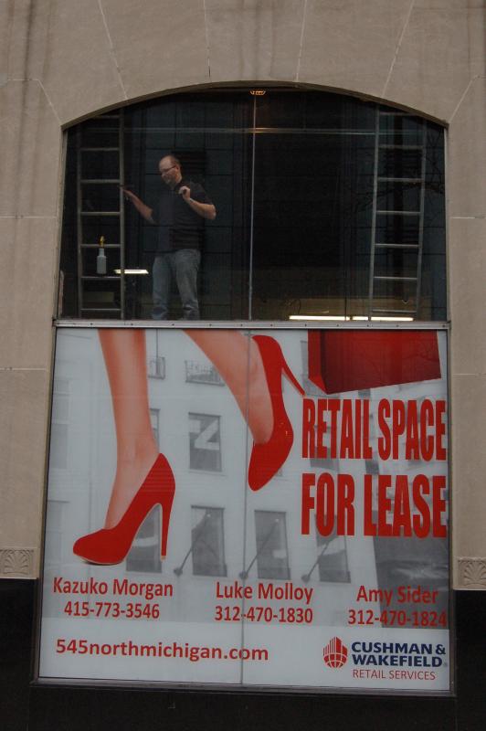

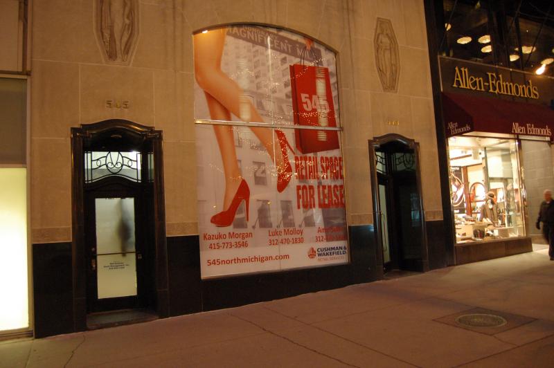

We ended up reverse printing on low tack clear and laminating the back with white and installed on the inside of the glass instead of the outside. Take a look.

Looks nice - I thought there was a ton of bubbles in it at first until I realized those are just Christmas lights or something...Very cool.
Ponto
...nice legs...I mean install.........
(I hope the white was lo tac as well.......)
