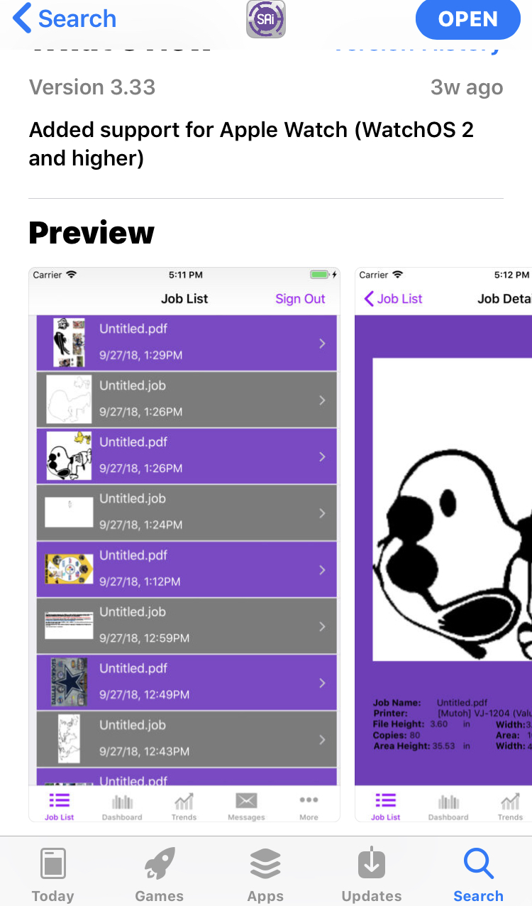

We were with Caldera for awhile but we dropped them. Primarily for their adaption to mac software updates issues combined with the nickel and diming us to death. Apple would make a new release, Caldera would tell us to hold on. Caldera would make a new patch to adapt to the new apple release and then something wouldn't be right with the new release. Caldera has a great system if it's what you need. We also got tired of the dongle too but just taking a quick glance on Caldera's site now it seems they may have removed the dongle requirement finally. With Flexi no dongle and you can download anywhere anytime and go. Flexi has it's limits also but not enough to make us switch back to Caldera and be under their thumb again. The problems we had most probably won't though. We have a print system and Flexi just fit better. Flexi also has a iphone app as well that you can check real time production stats and projected future sales based on machine activity. Search the app store for SAI Flexi, Caldera doesn't to my knowledge. If an employee says they printed something or cut something already you can jump on the phone app anywhere and see if they are telling the truth and when it was complete. Also Flexi allows up to 5 drivers the last time I checked. Go ask Caldera how much 5 drivers would cost.

App example
