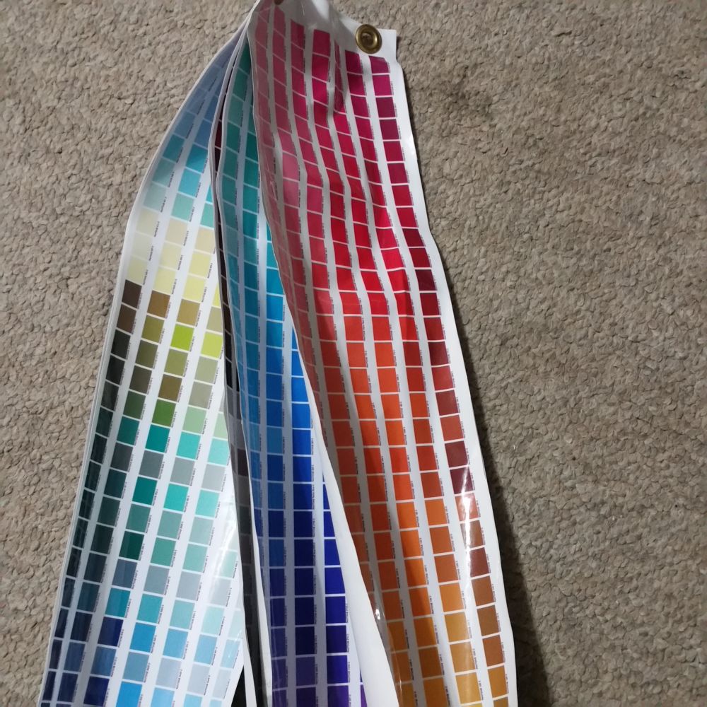

Print out you pantone chart. Take it with you to the job you need to match up.
We took ours, cut it and grommets.
