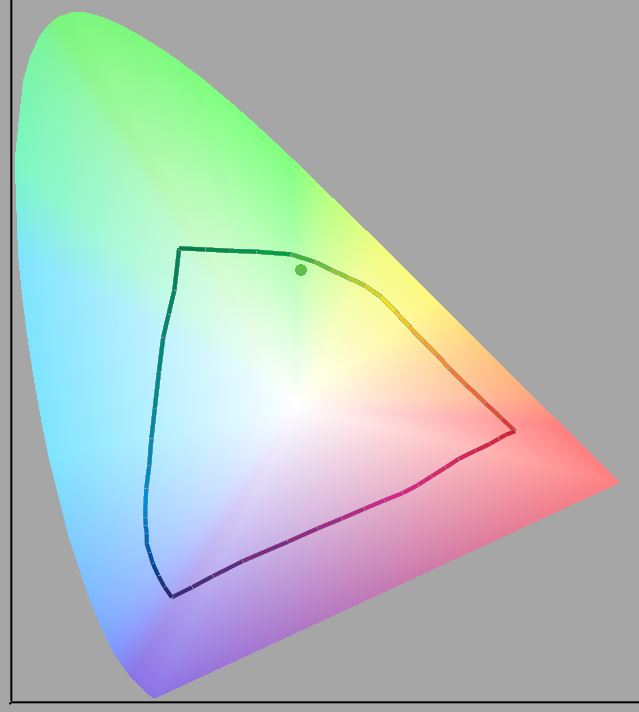

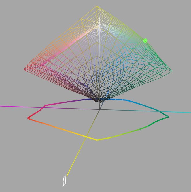

Our process is to take a spot color measurement of the specimen using a spectrophotometer. This provides an accurate LAB-based definition of the target color (in your case it would be a sample of 3M Electrocut 7125 vinyl). From there, we can plot the color's position in relation to out printer's gamut on the media in question. This gamut is based on the custom ICC profile that is being used by the RIP, so it is highly accurate to our printer's ability to produce color on the specific media. These plots shows the location of Pantone 360 C in relation to the gamut of 3M IJ180C vinyl on an HP Latex 260, @ 8-pass, using 3D and 2D plot renderings.
Alternatively, we can generate a predictive Delta-E in the RIP. Either will give us a very accurate prediction of our ability to simulate the color(s) in question. In this case, the predictive dE was 1.88
By the way, we try to avoid using the term 'Color Matching', as it can reinforce unrealistic expectations. Terms like 'Color Simulation' are preferable.
