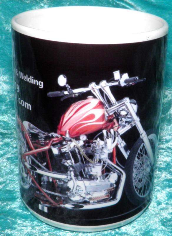

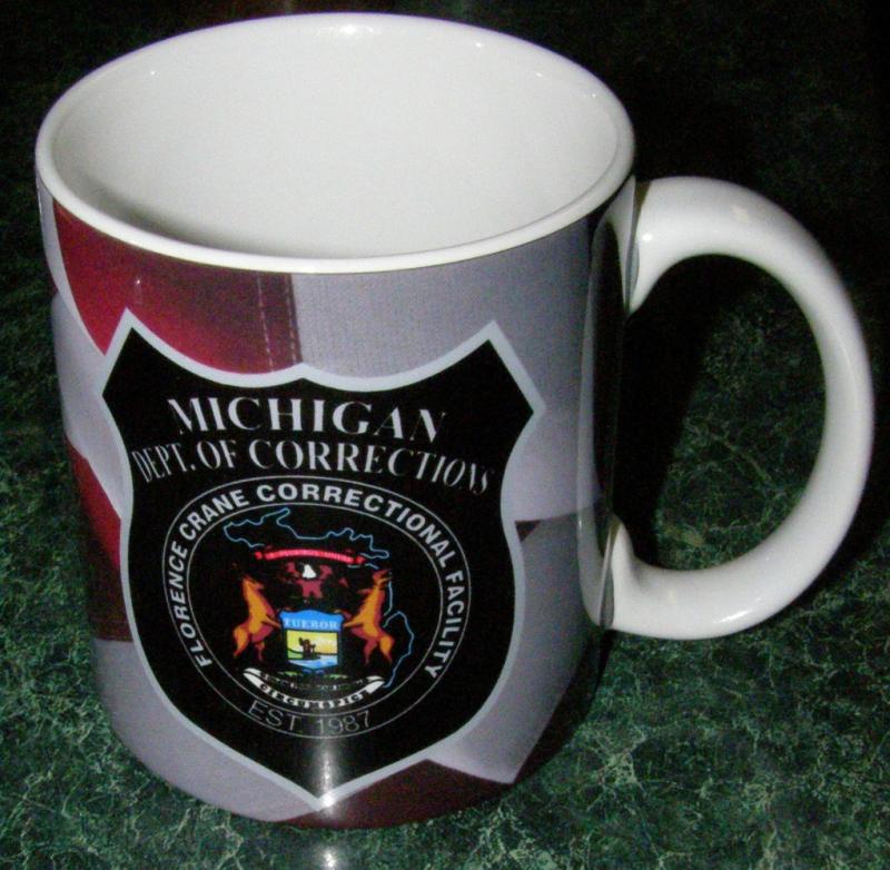

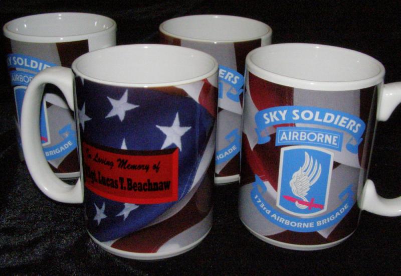

couple of things - I use a Ricoh with sawgrass inks and with the powerdriver from Sawgrass colors are very close, you just chose which type of item you are sublimating and it adjust the colors automatically for you - as for the printing to the bottom and up to the handle - had at least 6 different presses - get rid of them and use a cactus wrap and do them in the oven. the problem you have with a press is the handle and bottom wick the heat away like a heat sink causing the fading in those areas - when you put them in the oven you heat the handle and bottom the same as the rest of the mug (place them upside down) and the image will go to the edges. - never tried on the handle but have done hundreds full to bottom and to handle edge. I use 10 wraps - 5 in the oven and 5 will be cooling, unwrap, wrap next set and then trade at the 15 min mark - can rotate thru a lot of mugs that way when you get a rhythm going
I forgot about this. Yes, this does work really well. I've got a couple of different profiles that I use along with their ColorSure Palette and that is what I have been using for my small format printing.
