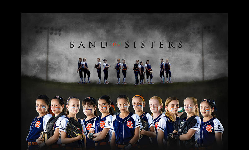

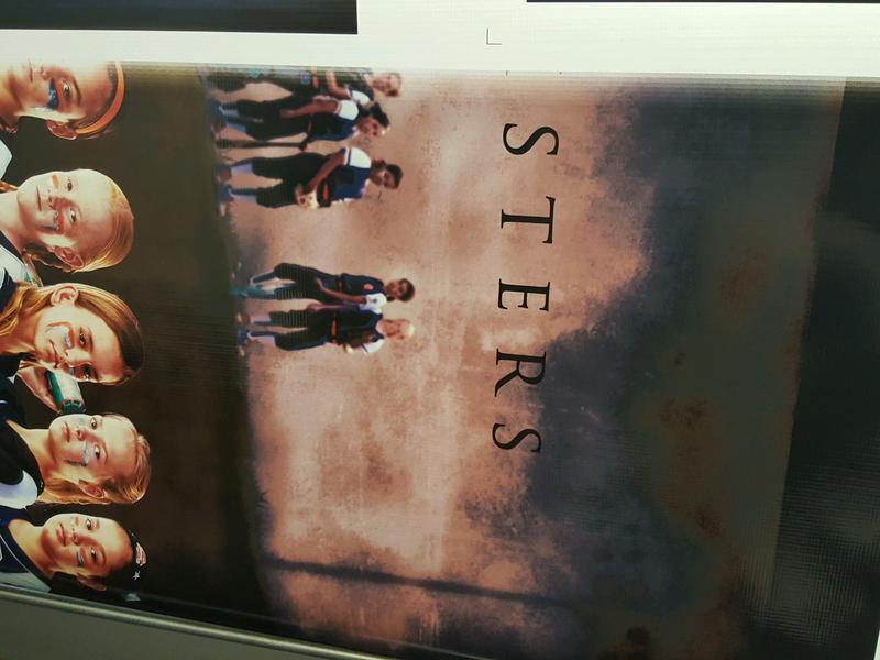

Of course as my luck would have it, I have this rush order, due before end of biz. End of biz being the instant this job is done.
Customer sends file (designed on a mac) not sure if that matters.
See the issues here.
what I see in photoshop.
This is what come out of my sc545.
Embedded profile is sRGB IEC61966-2.1. I have tried converting to CMYK.
Changing to Adobe RGB 1998. Saving as a tiff and changing the byte order to PC.
Tried density color control only in VersaWorks and a few more things but to no avail.
Still a just variations on the second image. Any ideas?
Maybe I'm just tired and missing some thing.
Thanks in advanced.

Looks like Adobe RGB was assigned somewhere as an input profile when the input profile should have been sRGB.
bob
Try setting your Rendering Intents for bitmaps to 'Perceptual' and send a plain vanilla RGB jpg file. This should give you as close to what you see is what you get as you're likely to achieve.
Correct Color
It's your printer profile. Nothing less or more and just as simple as that.
Bottom line is that your RIP converts your image, pixel by pixel, from whatever color space it's in -- or you tell the RIP it's in -- to whatever destination color space you also tell it -- which is the ICC profile in the media profile you're using.
If that profile matches what your printer actually prints, then you'll get prints that are accurate representations of the files you send the printer. If it doesn't, then you won't.
It's not an issue of a mis-applied input profile. That can certainly happen, but it will almost always make an image overall hotter or cooler depending on the move; what it will typically not do is make a neutral shift like the one you see here.
Whatever printer profile you're using does not convert your images to -- create dots that relate to -- how your printer actually prints, and you will always see that in neutrals first. Simple as that.

Tried tweaking in RIP. Didn't work. Don't know how to effectively create new profile. Tried "density control only" in VersaWorks to no avail.
Maybe try GBV and changing Matching Method to perceptual in Color Management? Might help, might not?
GBV produced a different result. But still no were near what I was seeing on screen.
I thought the same. But I gave up trying and eventually gave up. Refunded the customer who was fine with it.
Tried this. Still poor results.
This ^^^
Took a leap and tried printing with the GCVP profile in VW. Not sure why I didn't go this route in the first place. Maybe I was afraid it would lay ink weird or produce banding. I dunno. Ultimately, this was the fix today, and probable was the fix back then. Still unclear on why it occurs. But glad to have an acceptable work around.
