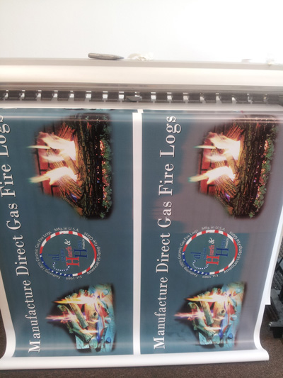

I am having problems with the right side of my prints losing the color. It is always on the right, and on all medias. My colors seem to just have either a different color value, or a different color profile assigned to the right side of the prints. Can someone tell me what would cause this please?

not sure what your problem is.
It maybe an encoder strip problem have you tried to clean it if not try cleaning it but be gentle.
evie
Cleaned many times, sometimes it has just a staight section, with a different color value on the right, always a clean print, just different colors.
mudmedia
rip processing problem? In the rip do you just have copies of the image your trying to print or in your actual file is there 2 images side by side?
evie
I opened one image and printed it as 2 copies. Even if I print one image the fills the media, it still happens.
