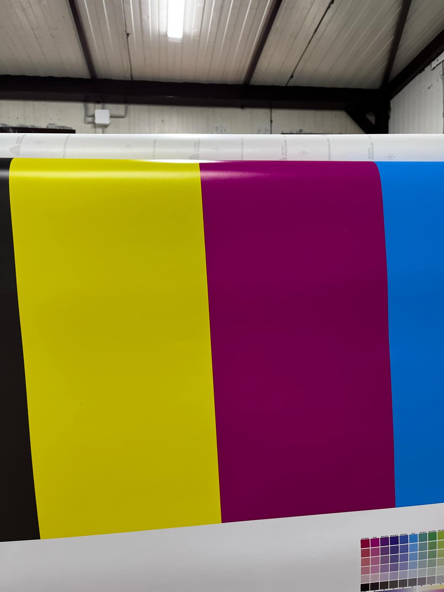

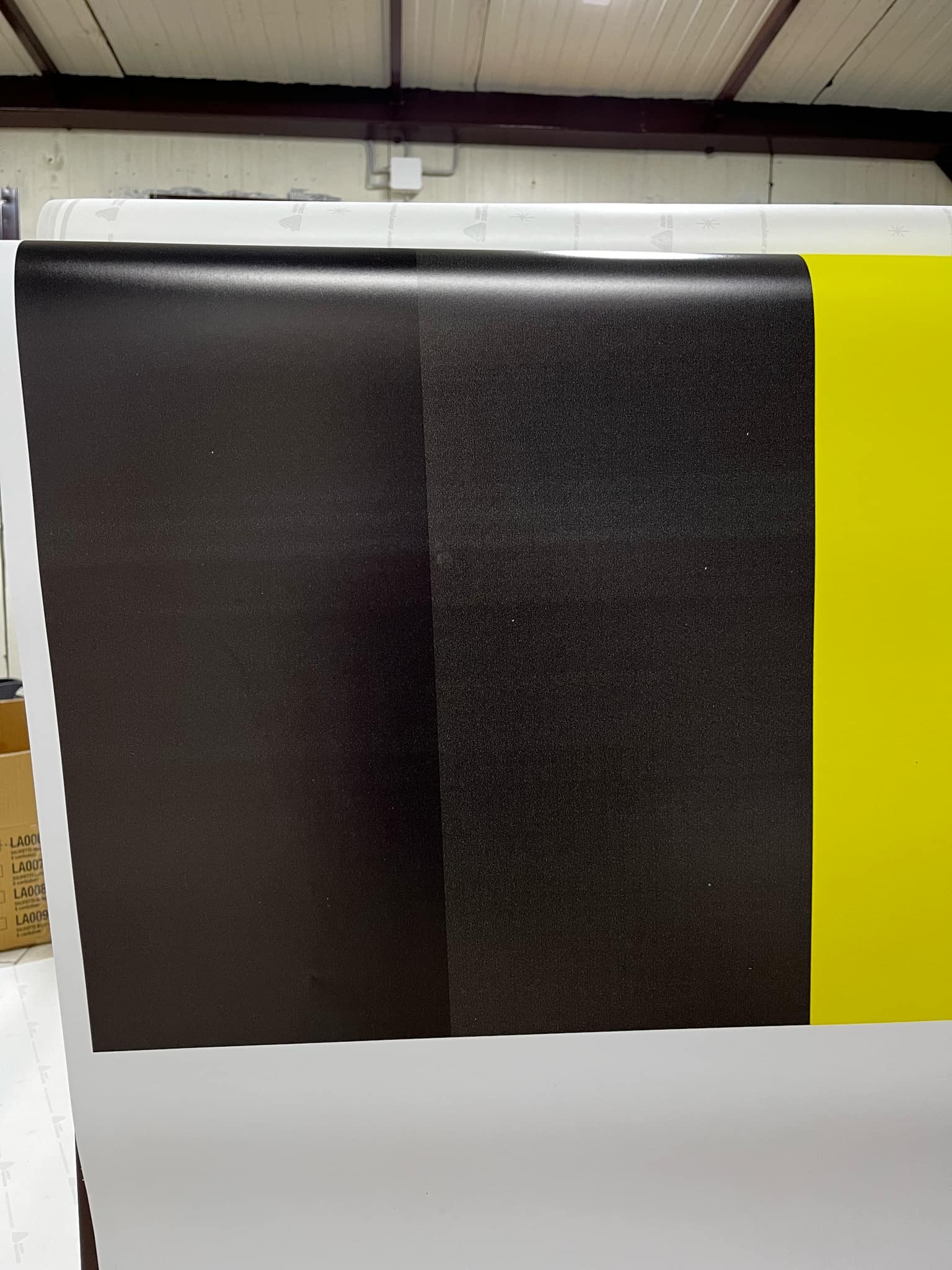

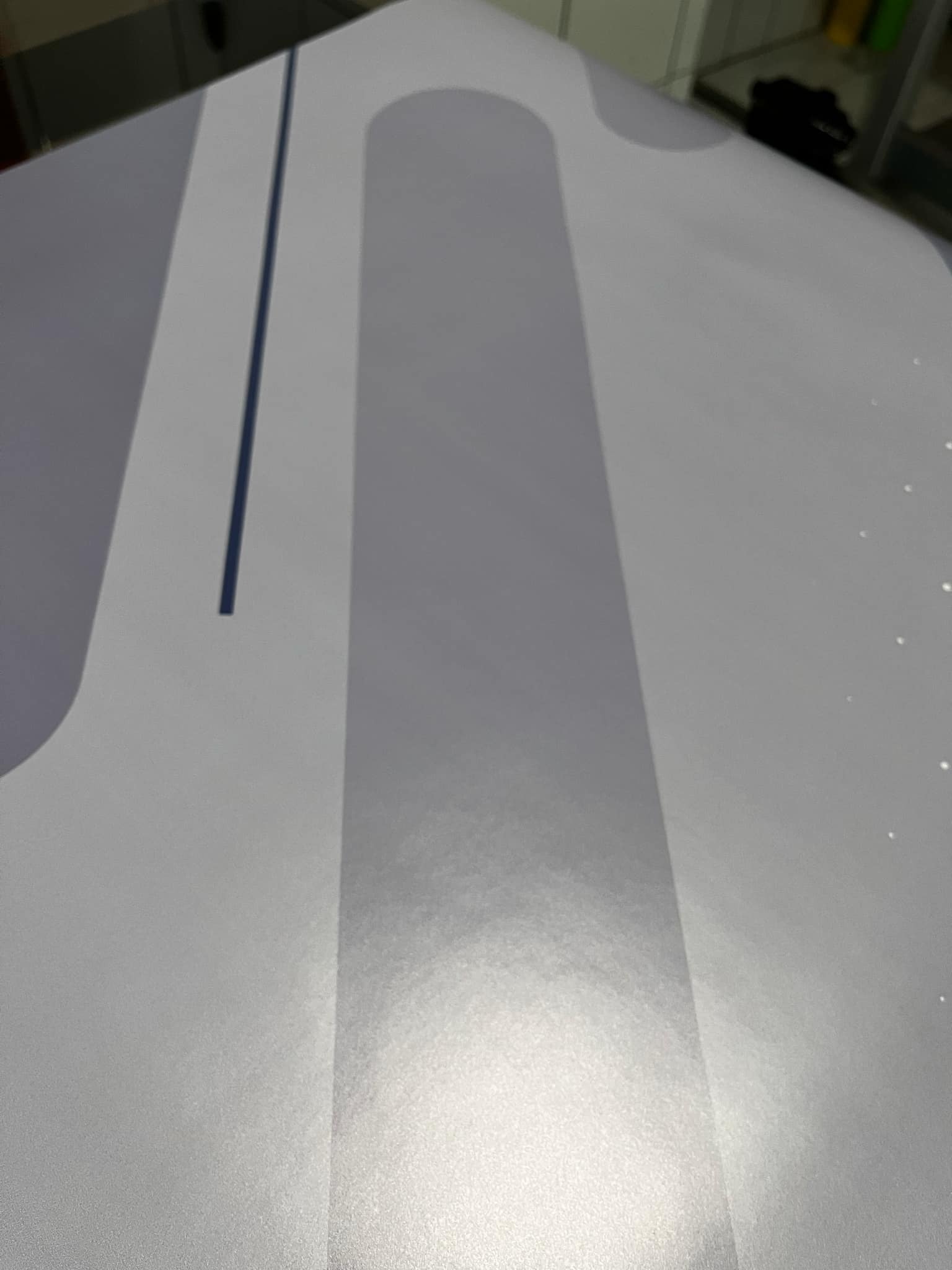

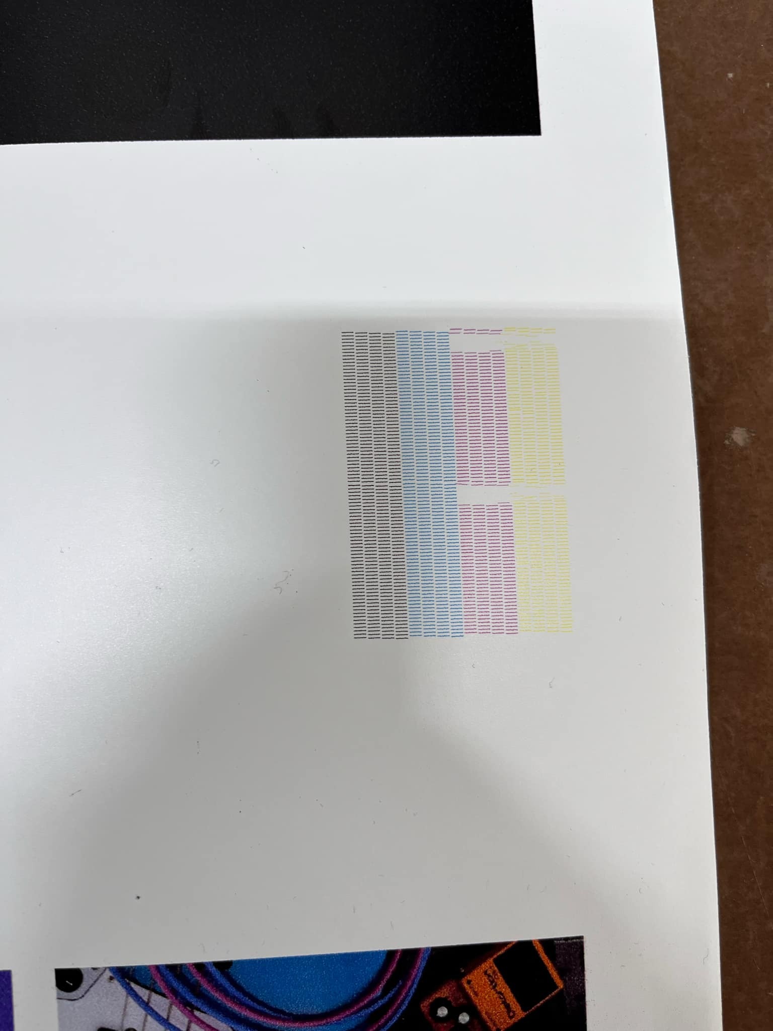

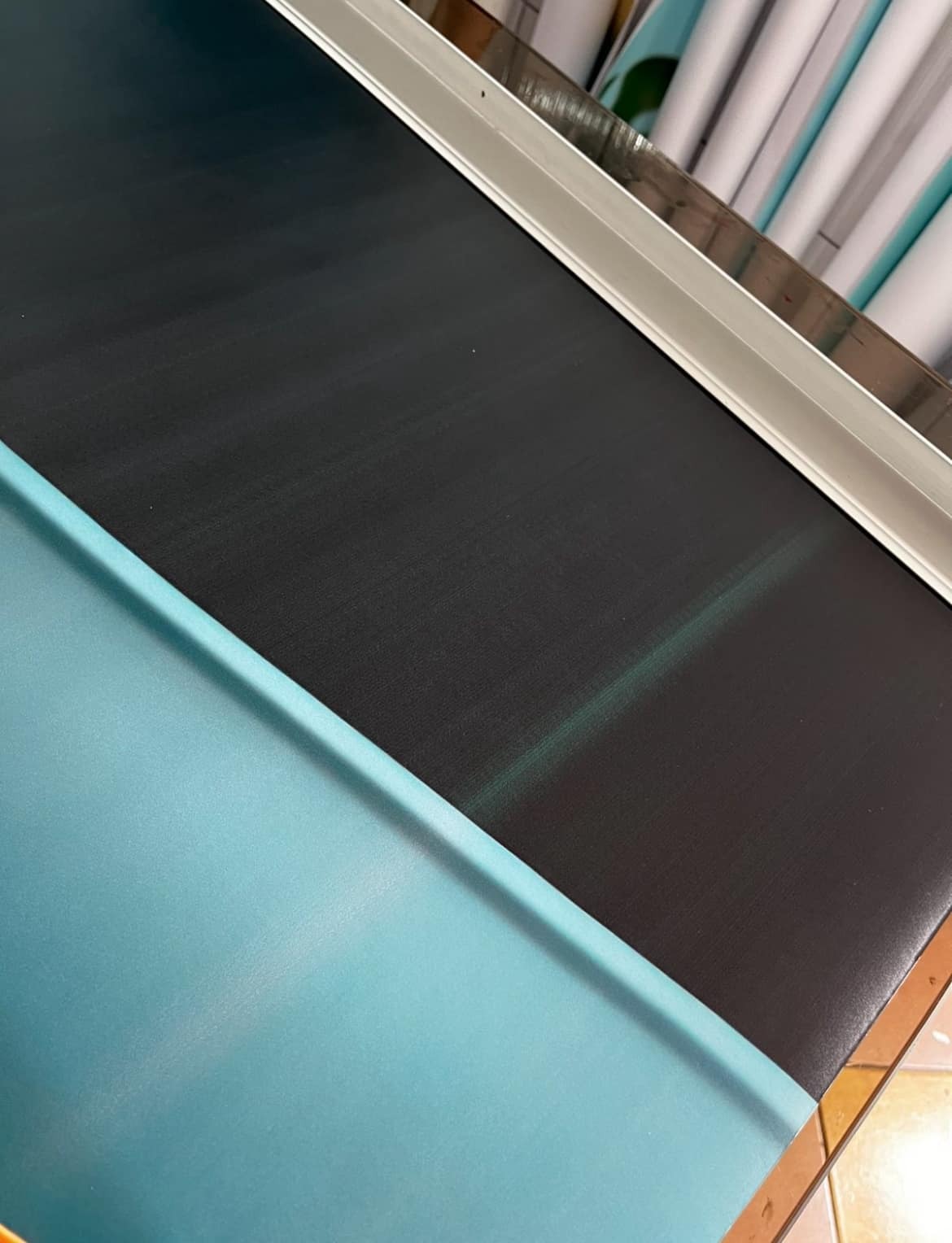

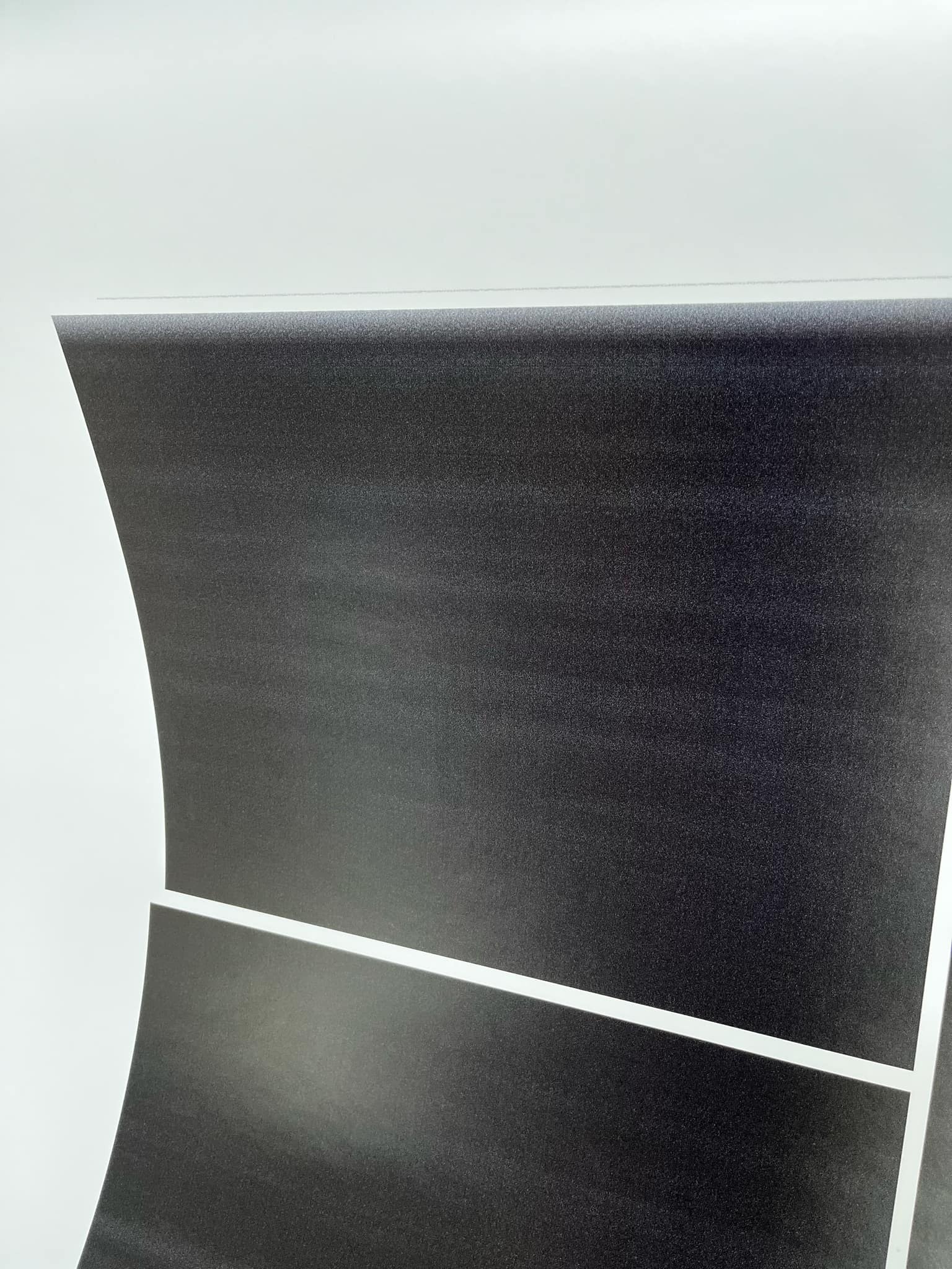

Hello friends, I have problems with the Roland SP-540i plotter.
The first problem is that I don't get such good and strong colors. The biggest problem is with black color, I use Preset: Signs&Display.
The problem with this mod is that the black color is very pale, and the other colors are okay (they can pass, but they are not ideal). But when I use the Pre-Press U.S. mod. I get the perfect black color, but the other colors are very bad (dark).
Drugi problem je što štampač u nekom trenutku "gubi boju". Ne dešava se stalno. Recimo, danas štampam neki vinil i otisak je idealan (govorim o gubitku boje), nakon par dana se desi da štampač ostavi linije za prenos boje (gubitak boje, ne mislim na linije ostavila loša dx4 glava, slike su u prilogu)
Dumpers changed!
Please help me, I've been going crazy for months with these problems.
Sometimes I even consider switching to the HP Latex 3x series. Your opinion?
Sorry for my english, google translate :)

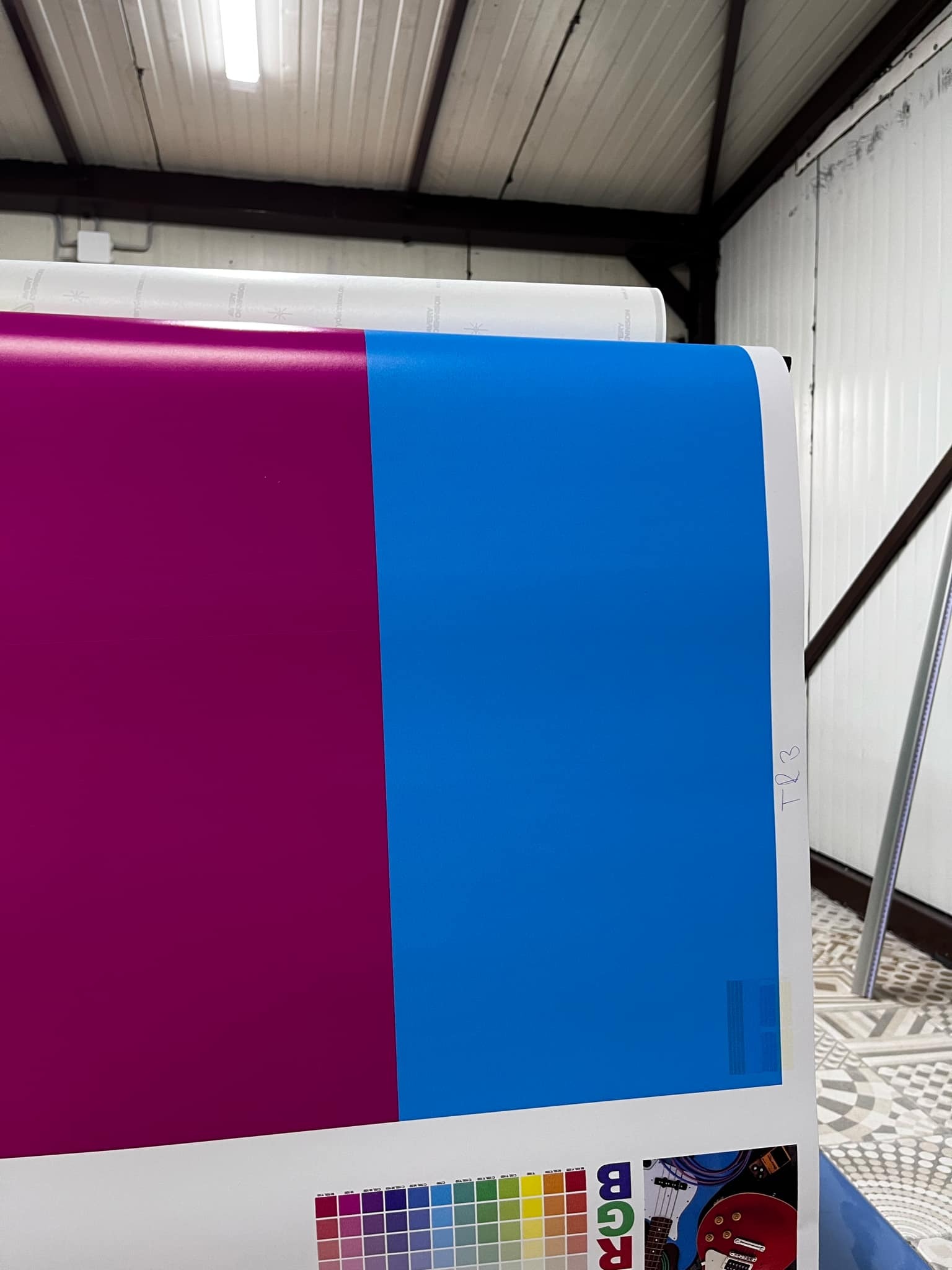

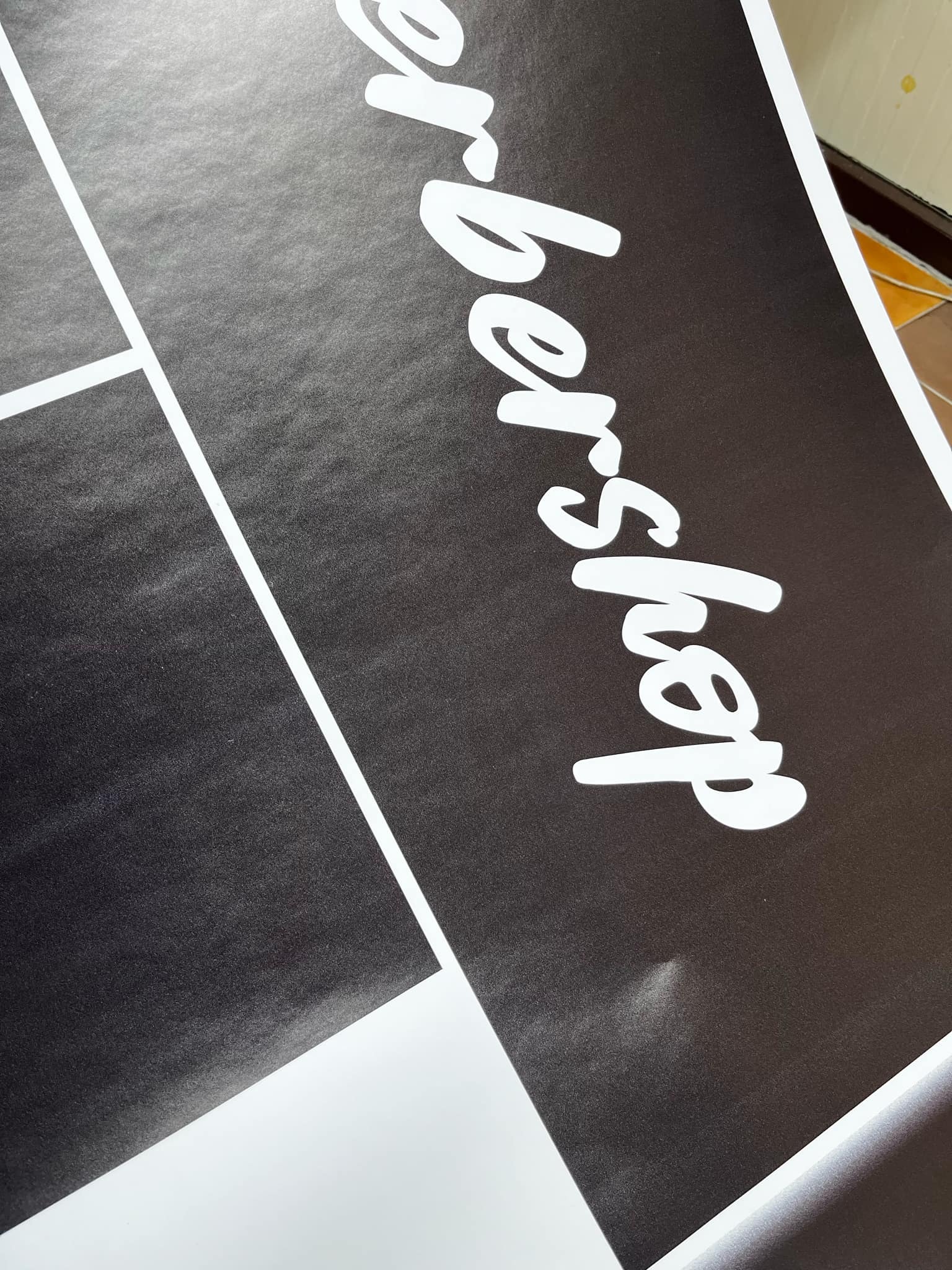

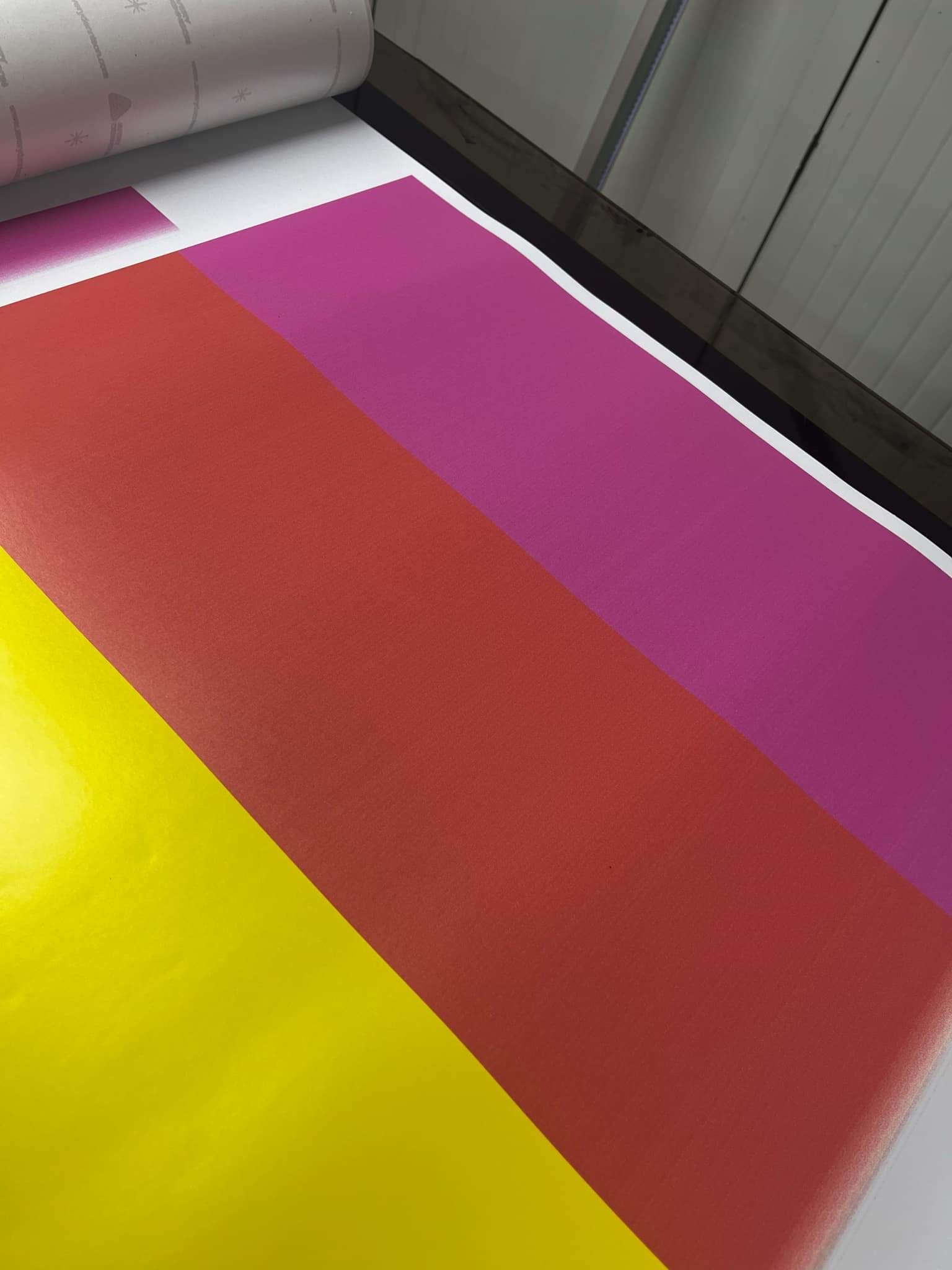

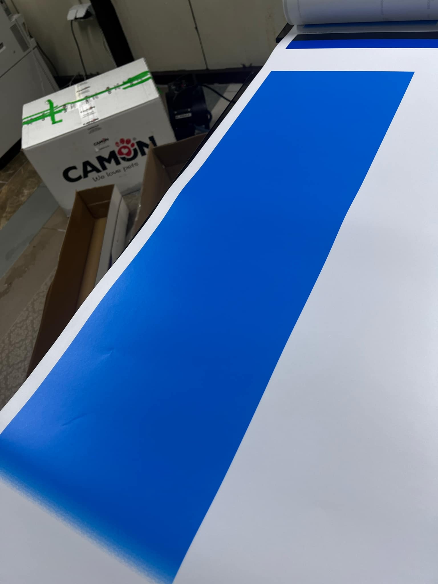

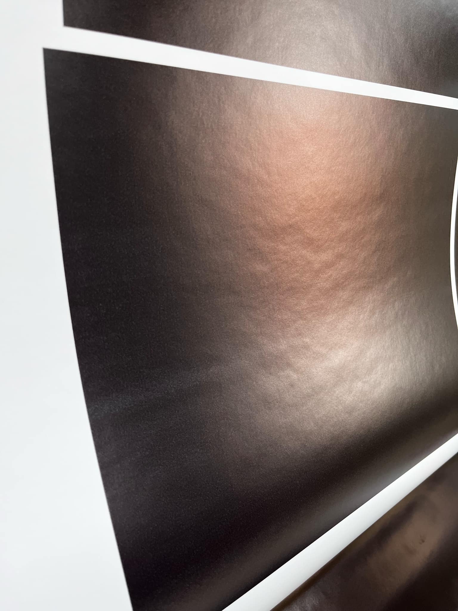

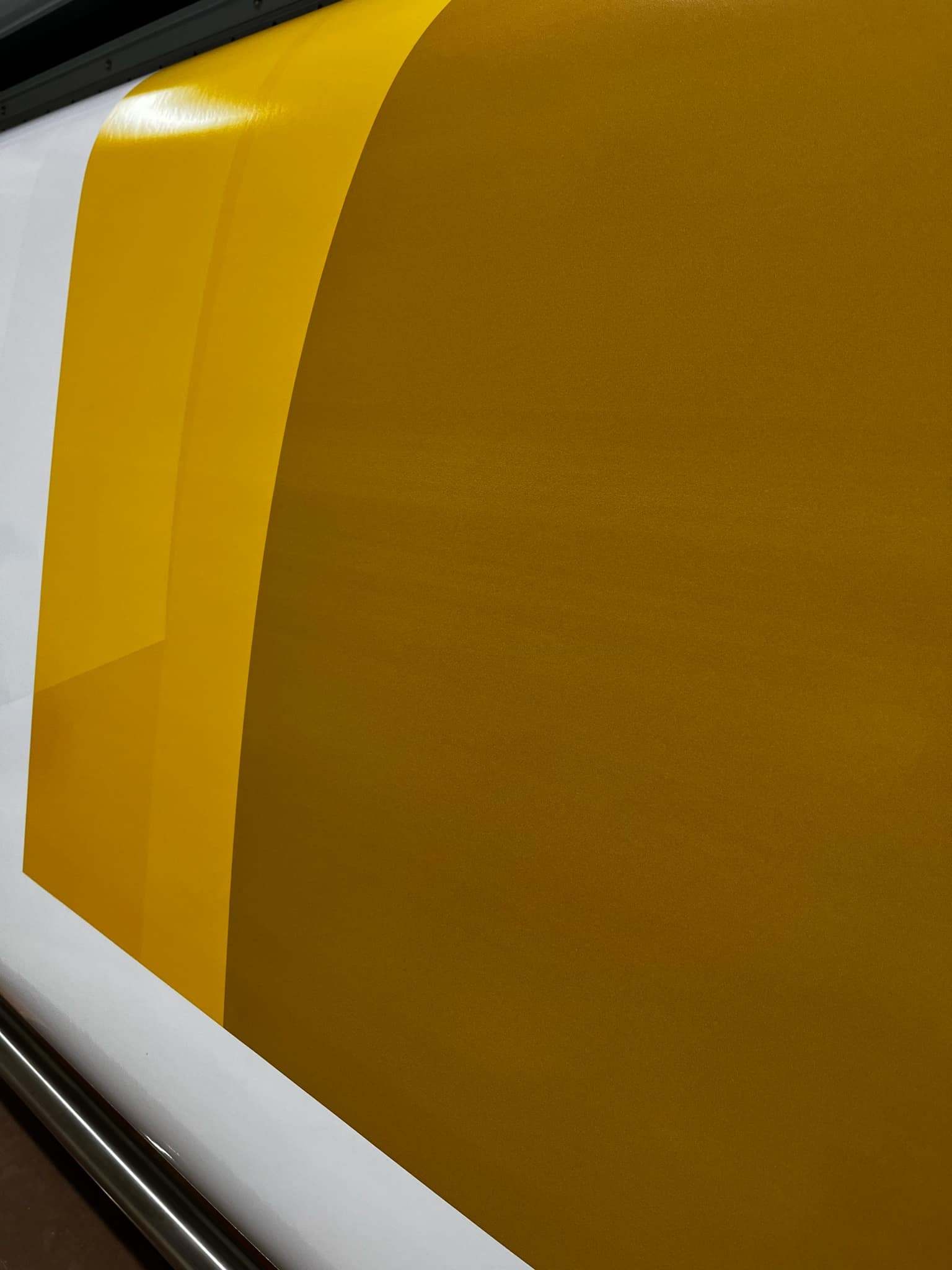

designtcd
Hello, True Rich Color 2 matched my colors. But the printer still leaves me faint lines that are not constant.
K/C PRINTHEAD REPLACED / CABLE HEAD
DUMPERS ON BOTH HEADS REPLACED
CAP TOP FOR BOTH HEADS REPLACED
The problem occurs on almost all materials
Please help

damonCA21
Please help
Try changing your profile to density control only in versaworks. This will print black just using the black head, rather than a mix of colours. This can often give a better more solid black
Zoogee World
Domed Promotional Product Supplier
There is certainly issues with your Yellow/Magenta Head. Try a 48 Hour head soak to see if it revives, otherwise you'll need to change that head to remove those lines when you have colors that use Magenta and Yellow.

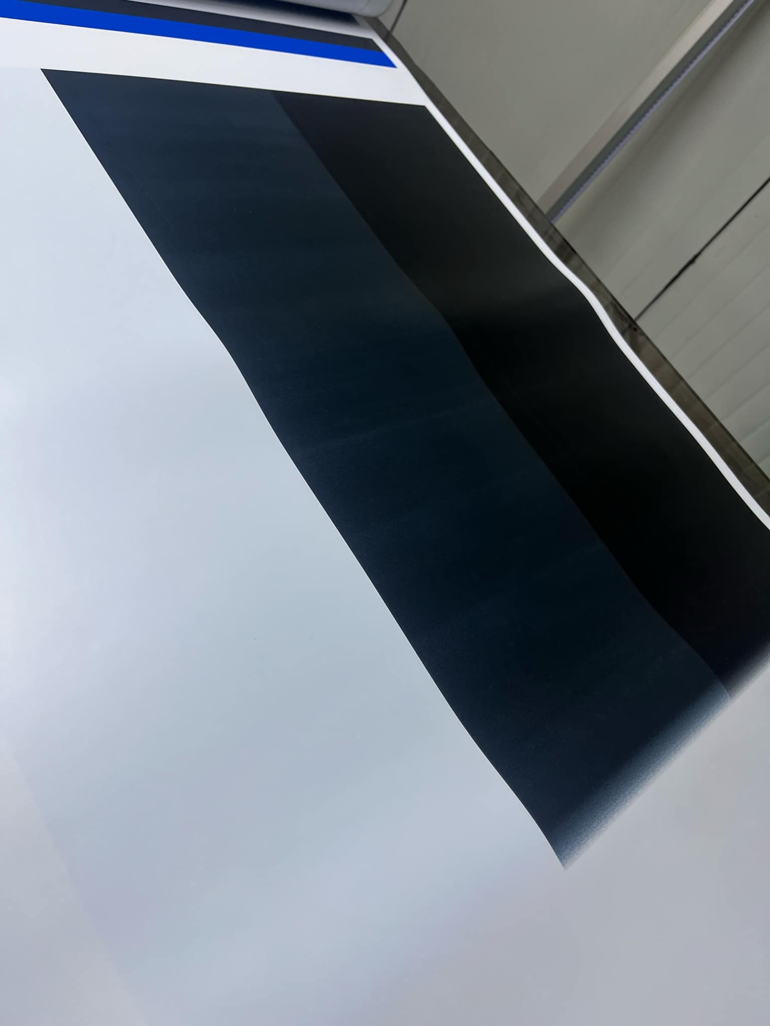

designtcd
Unfortunately, it still happens, I also put the black color in the graphic preparation as
C: 0
M: 0
Y: 0
K:100

You can also try printing in high quality. This is slower but can often solve problems with the ink banding. Did you replace the dampers for OEM Roland ones or aftermarket?
designtcd
Here's some new info, I tried unidirectional printing, high quality, slow down the speed... But still the same problem

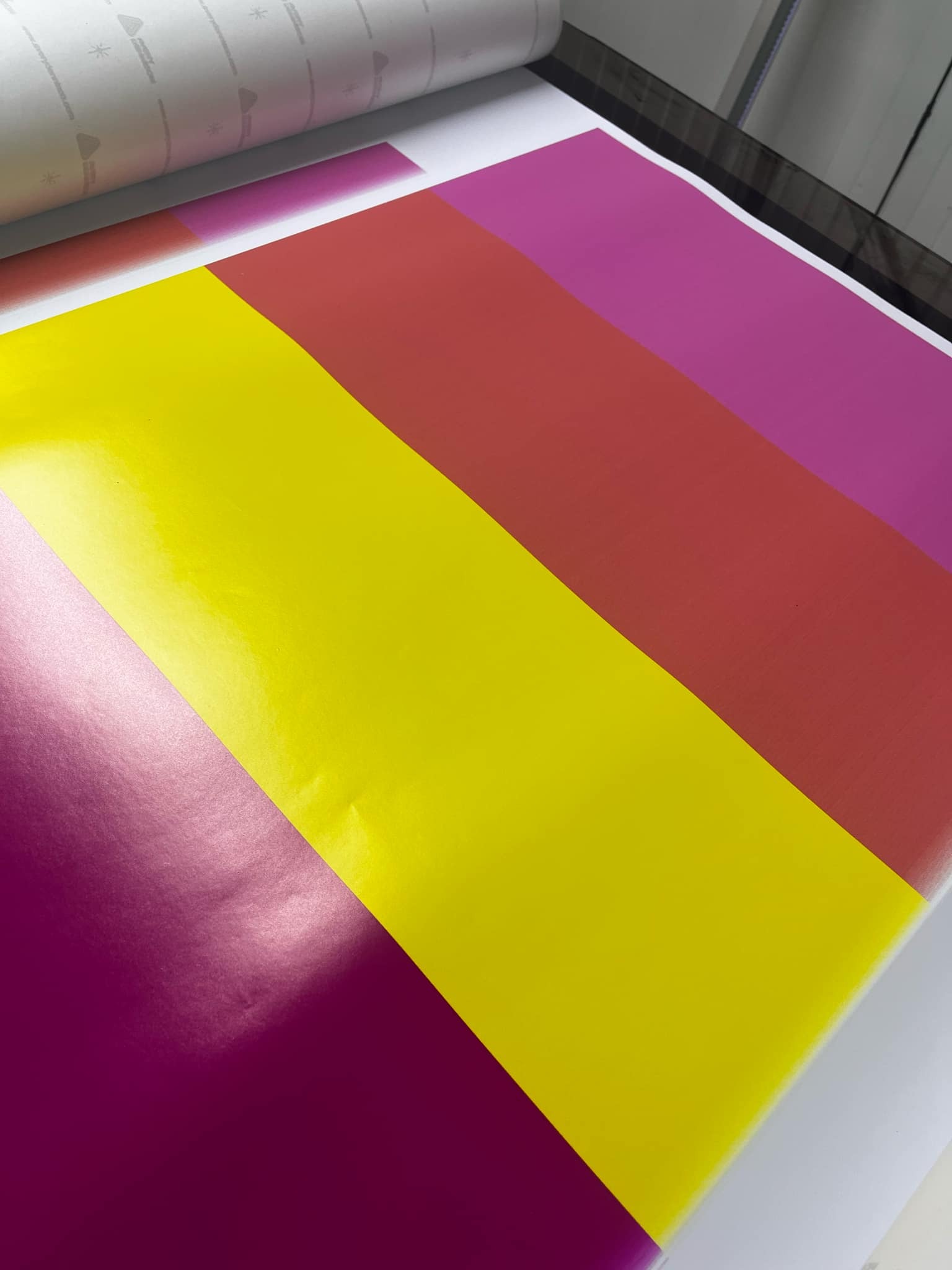

designtcd
I printed CMYK color pattern.
I turned off the C/K head and printed complete CMYK + BLACK (C:100+M:100+Y:100+K:100)
Pictures attached.
Then I turned off the Y/M head and turned on C/K and reprinted CMYK + BLACK (C:100+M:100+Y:100+K:100) Attached images.
After that I turned on all heads and printed again CMYK + BLACK (C:100+M:100+Y:100+K:100)
Please help me, C/K head replaced less than 5 days ago

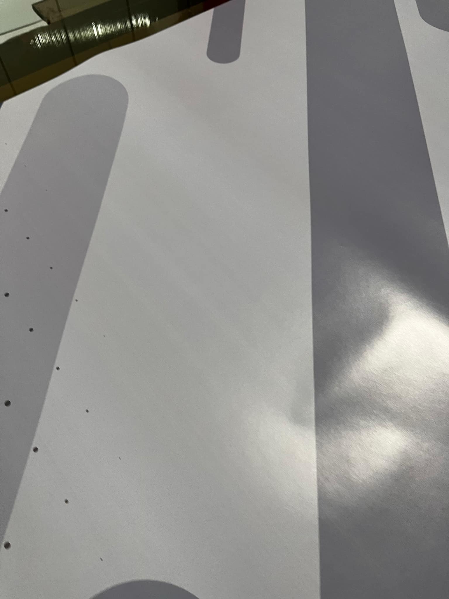

At this point if you can't get it printing properly, pay a technician to come out and fix it for you. At the moment you are just wasting money chasing things that aren;t causing the problem, so it needs investigating by someone with more experience
designtcd
Update: Problem solved by installing more pinch rollers and cleaning the rollers. Also using the ICC profile. Temperature 36 and 42. Unbelievable
