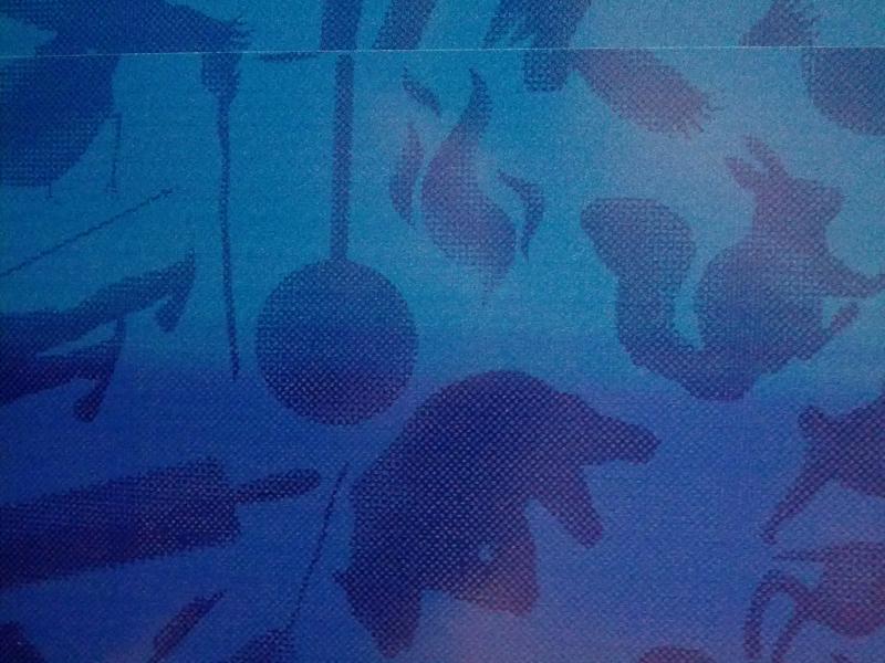

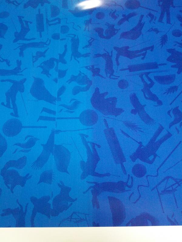

I think it's difficult to see anything from the pictures, but if you have an idea, please let me know.

Hrmm... it's funny that the dot pattern doesn't seem affected at all. If it is the data issue I mentioned, you'd be able to tell right away, as the number of passes would change, and your print might actually be elongated.
If this still happened randomly with the TIFF, my best guess at this point is something in your ink feed, be it in the cartridge assembly, lines, dampers, or manifolds. Did the problem go away entirely with the TIFF though, and is only appearing in the EPS?

That is classic starvation. Your magenta is dropping out which is causing the color change. It's going to be a damper/o-ring and/or cap top/pump issue.
