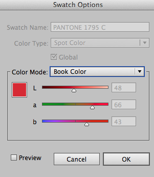

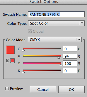

SOLVED - Kind of...
Well, after further review....
The difference was in the swatch settings. I double clicked the swatch and noticed 3 different variations
Book Color - This is what I want the output to be
Spot Color - CMYK
The lady who sent me the file must of made her own swatches and named them the same as the pantone book.
Any feedback, tips, etc. is welcome.
Thanks Team!
