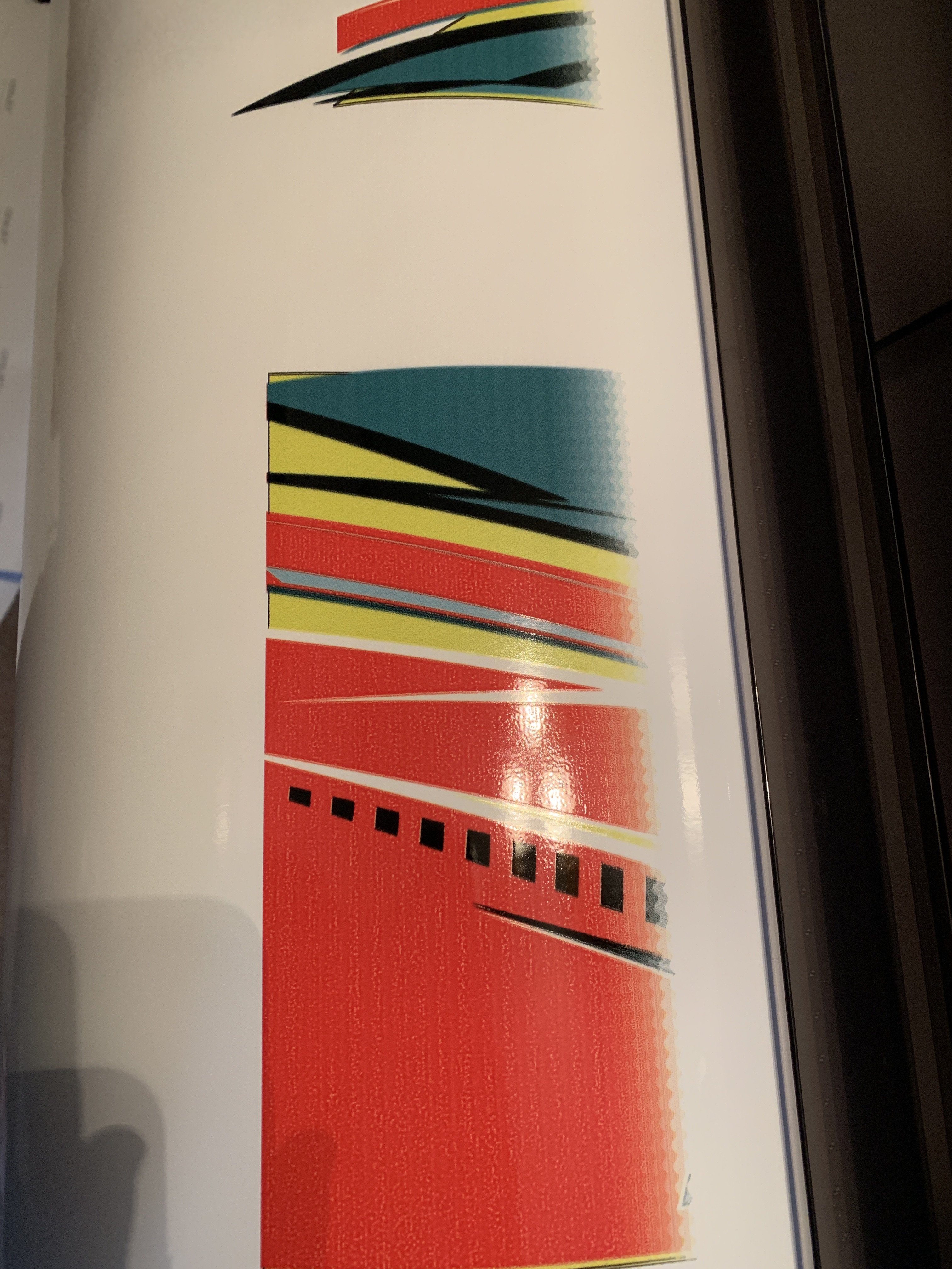

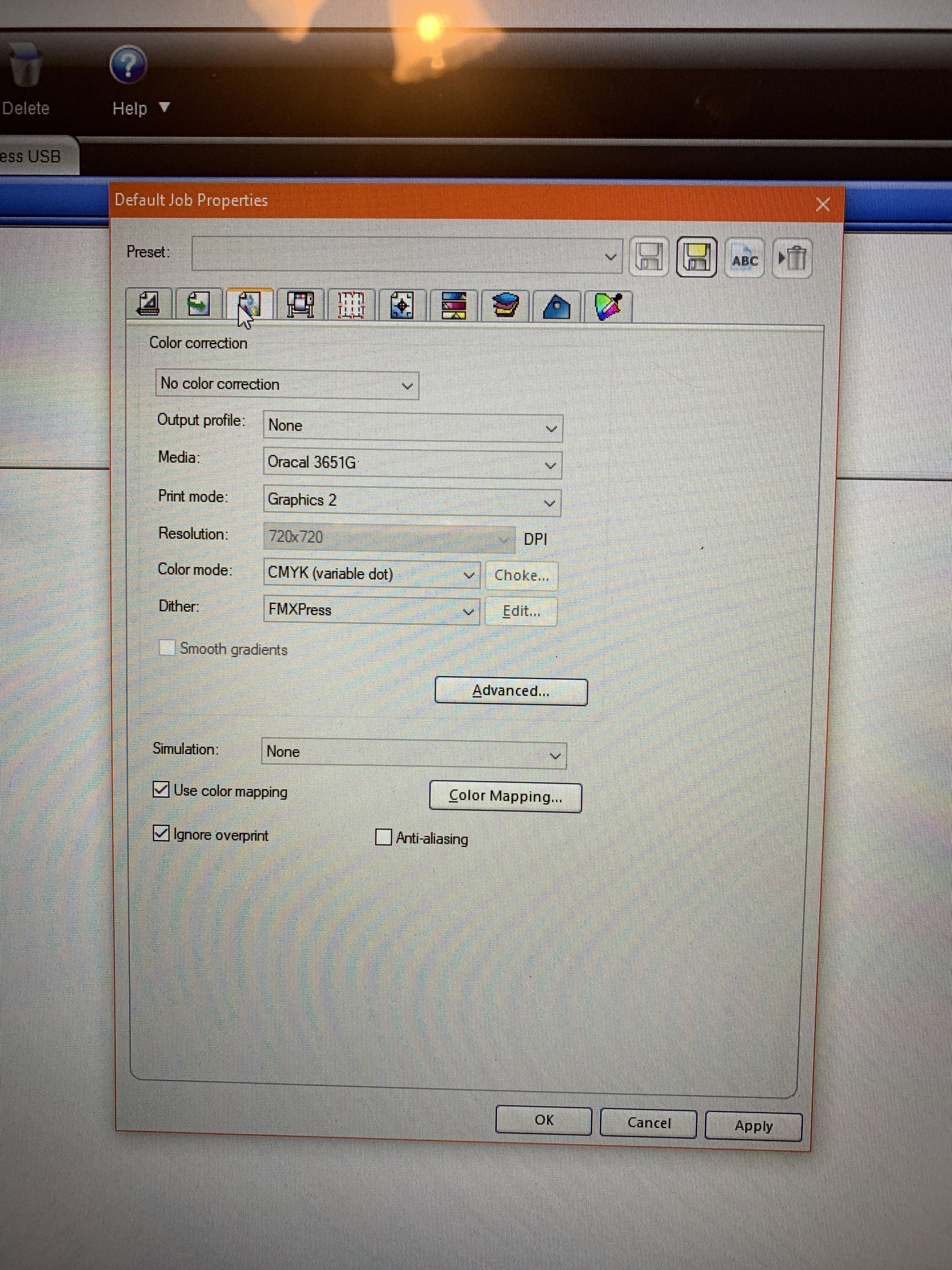

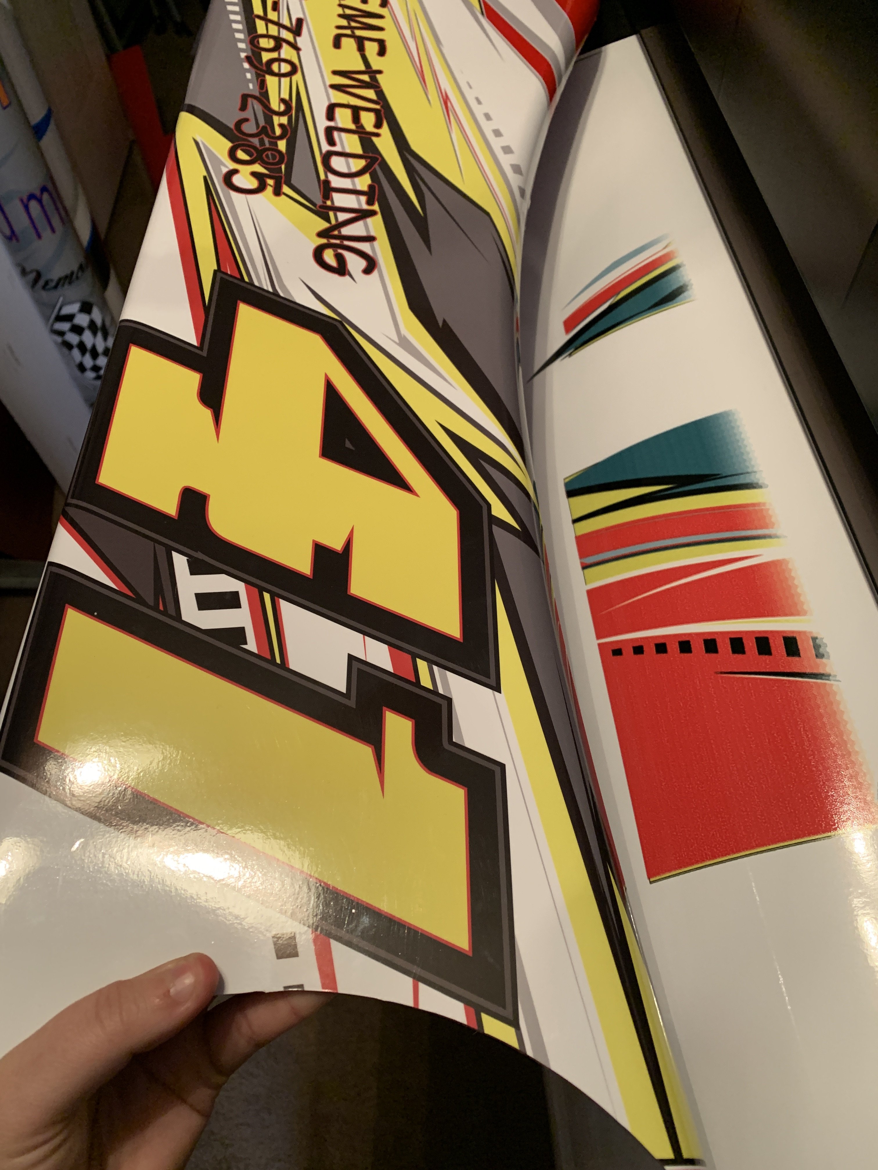

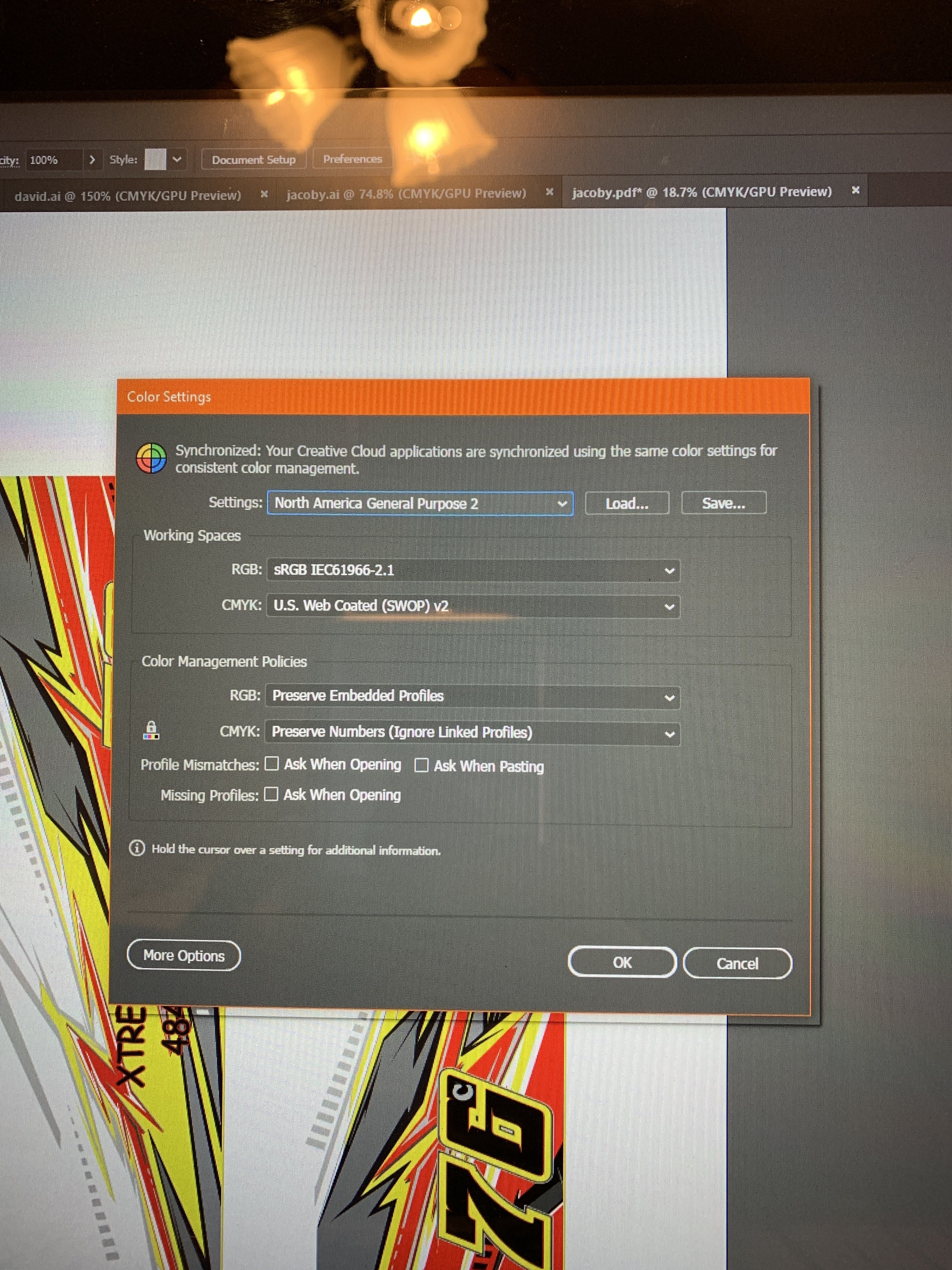

I printed a wrap before and the colors came out perfect. See first image below. I am trying to print it out again and not I can’t get the yellows or greys to match. See second picture below. Graphics created in Illustrator and then imported to Flexi. I am at a loss. Wasted so much ink and vinyl trying to fix this. I’ve downloaded profiles from Flexi and also Oracal site and still no luck. Ready to throw in the towel on this.

Is that as solidly as your printer will print?
Maybe it's the photos, but things seem kind of weak and mottled.
Generally speaking, the gamut on color is wider when printing in RGB, but your equipment, desired output and vibrancy are what should drive which color model to use. We typically use CMYK for most of our prints, but some colors are more accurately reproduced using RGB.
We've also not seen a substantial difference in color fidelity using specific profiles compared to most of the preloaded, non branded ones in VersaWorks.

It prints a lot more solid. I was trying different settings and it printed like that. The graphics that I already applied are completely solid. I have a Mutoh 1204
