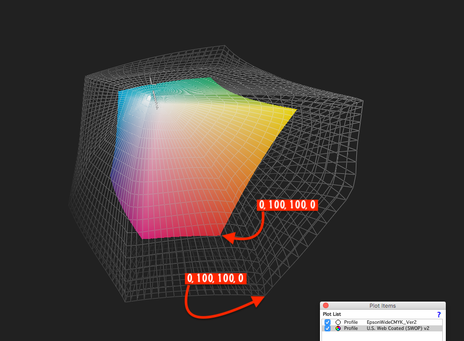

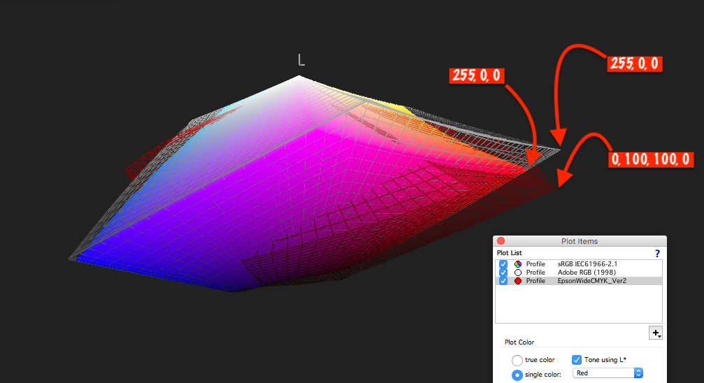

Earlier posts mention RGB and CMYK values for a basic, pure red color. What's missing is the name of the color space for the values.
The attached image is only to illustrate where "pure red" lands in a 3-D plot of the individual color spaces. Whether one will see an actual difference in print is an exercise for one to test.

Same values, two different results. Testing such in print should be readily noticeable.

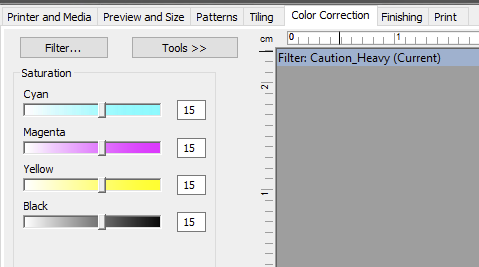

Some colors cannot be hit within the CMYK spectrum of 100/100/100/100. You have to go beyond 100% to achieve those rich deep hues.
We use Onyx RIP and you can do a color bump within the RIP to achieve those particular colors when necessary.
We call it a saturation bump and it is the same way you would increase saturation for a backlit sign.
We print our own "Almost Pantone" chart using the Pantone swatches saved out of our current version and colorspace of Adobe Illustrator.
Print one at the regular setting, and one at a 15% universal color bump.
We keep samples of those around the office off of each printer, and then we can compare the Pantone books we have to the printed samples to see which printer/setting is right for a particular job.

Can you explain how to access this "color bump" in onyx? I've never heard of that but it sounds awesome for the correct circumstance.
jfiscus
Rap Master
I
In Onyx, when you rip your file, the 3rd(? - sorry I'm away from that PC) tab is for color management. In the top left there is an area where it shows the CMYK & spot color channels. You can type an increase into those channels.
