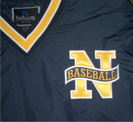

Common embroidery font, any thoughts on what it is?
binki
note the serifs on the square ends of the letters and the square O's. We don't have it in our embroidery font library nor do I have anything real close to it. It is thinner than an athletic font.

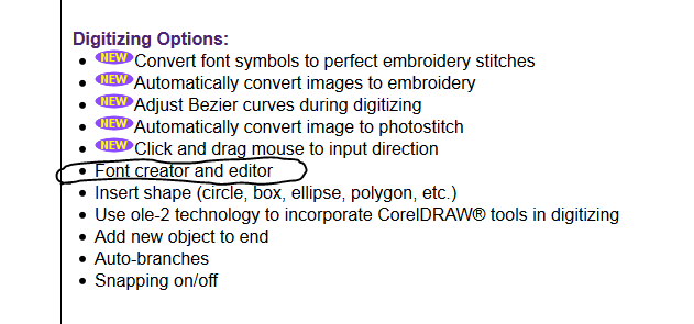

It looks like at at least with the latest version and the previous one that it was a digitizing option. I say the previous one as well, because the Font Creator option isn't listed as "new". I don't know what version of XP you have, if it's the latest (5 I think) or if it's earlier will determine if you can still get it.
Having said that, I'm a huge fan of Wilcom and been a user for a long time and I've used various other programs over the years (including Wings modular, which I still keep a copy of). Plus I'm able to do more for my customers that have Wilcom (font creation for one, motif creation for another) that aren't DST files, but use Wilcom's ESA files (providing that they use the same version of Wilcom that I do, that changed with E3 unfortunately).

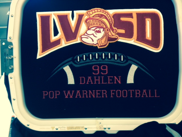

Here is the finished product. It is on the front of a hoodie.
3 layer twill with an insert on top of that, embroidery for the rest.

Looks good. Those onsie twosie jobs are a lot of work, when they are not digitized already!
Looking good.
Isn't that the truth. I do like the one offs a lot, typically able to do more artistic work then the corporate logos, but I hate it when they want to bring in their own files one the one offs that take 3 times longer then they should if it was properly digitized.
