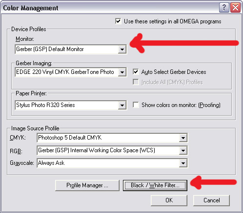

We had the same problem. The color display should be addressed by trying different settings in the color management system accessed under the file menu. My settings are shown that work for me. You may also want to look at the Black/White filter settings for your monitor and see if you prefer them turned on or off.
