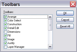

Your right. I thought it was there. Check instead under View > Toolbars to see if you have a Fill and a Stroke toolbar. If it isn't available, then it's pretty much a sure thing that only CS is installed and that your dongle is authorized for.

I just dug out the original purchase receipt, says "CS" on it.
I wish I would have known there is a difference... So I'm SOL on this one?
