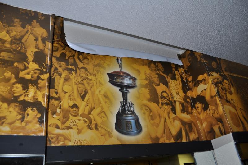

I have been asked to bid a job to remove printed vinyl from a concrete block wall (parts of it are already starting to peel off) seal the painted block and install new printed vinyl. Any ideas what to use for a sealer that the vinyl will stick to?

We have had good success using Thompson's Waterseal Clear Multi-Surface Waterproofer. Pay special attention to the instructions- it's very exact in surface preparation and application. We use LG's LD3880 Ultra-Tack adhesive vinyl film and cast laminate for our wall graphics applications. This is a very reliable combination. Good luck.

I agree, paint would stick better but it would be harder/expensive to paint these images (see photo). What about putting sealer / Thompson's over the existing paint? Is it a problem with the surface or the vinyl media? I did not print or install the first go round but I think it was Arlon material.

A couple heavy coats of plain old latex wall paint will help smooth out the surface ... then apply a seal coat as Roundman suggested.
You will have more surface contact, therefore better adhesion.

They make a block filler/sealer you can buy at a professional paint supply house. It smooths everything out and seals, it would leave you with a much smoother surface to adhere vinyl products to than a thompson's type product. It is thick like elmer's glue. If you have a strong enough airless and the right tip you can spray and then backroll a couple of coats and top with a high sheen topcoat.
Salmoneye
I would not apply latex and then cover with a seal coat. Many times moisture will come up from underneath on concrete block and fail the paint bond from underneath. Definately seal first and your top coat and sealer would both provide protection from the outside just like on any surface. If you are just wanting to seal up the peeling paint there is a product (I think made by Zinsser) called peel stop that seals up all of the peeling, chalking and checking paint.
