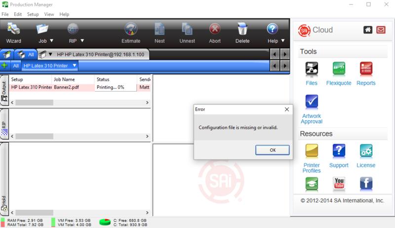

This started happening randomly. No idea why. I've tried deleting Flexi and reinstalling, and I even formatted my PC. Still no fix. I'm completely stumped. :( Any help would be greatly appreciated.
*UPDATE*: I tried a completely different computer, and even tried a completely different substrate, and it didn't work. Seems like this is an issue with the printer. (HP L310)

Since it only happens randomly, it may be a networking issue. If your printer is having a difficult time syncing the profile because of network issues, you may see this error.
I see that your printer's IP is 192.168.1.100. I assume then, that your printer is connected to a router and not directly to the RIP computer via a 2nd Ethernet adapter. Is that correct? If that is the case, you will want to be sure that the printers address (192.168.1.100) is not in the DHCP range of the router. If it is, then the router could be assigning the same address to another device on the network and your router could be getting "confused".
You could also try connecting the printer directly to the RIP computer via a 2nd Ethernet adapter on the RIP computer. In that case, you would give the 2nd Ethernet adapter an address of 10.0.0.5 and the printer an address of 10.0.0.10 (both would have a subnet mask of 255.000.000.000, no DNS, and no default gateway). This would eliminate any network related issues between the computer and printer.

Thanks for the ideas, everyone. Flexi remoted in and was able to resolve the issue. They had to grab a config file from that of a HP L360 and copy/paste it to my HP L310 directory and overwrite the existing file. After that, it worked again. So, something go corrupted somewhere. The odd thing was that it did this on a computer that had never seen my printer, or Flexi. No clue, but that fixed it.
