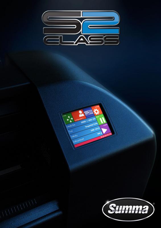

The new S-Class 2 was shown at the Sign Istanbul Show (Turkey) in December, they should have started producing them in January.
I wasn't at the show in turkey, but we - as a dealer - have gotten this information with the December Dealer Bulletin. We will get our demo unit at the end of january.
The new S-Class will be in the same shape as before, but will include:
  • a coloured touchscreen
  • a faster internal processor
  • an ethernet-Port (10/100Mbit), wireless will not be available anymore
  • USB A-Connector to transfer plotfiles directly from an USB-stick to the plotter
  • possibility to add additional pinch pollers in the field (as far as I think by technician), instead of the need to order it factory-installed
  • changes in the mechanics of the OPOS Sensor (will lead to faster processing) and less movements with sensor down.
  • modified Core Holders

Thank you very much for the heads up. I think it will be worth waiting to get a newer model. They should have these to show at ISA right?
