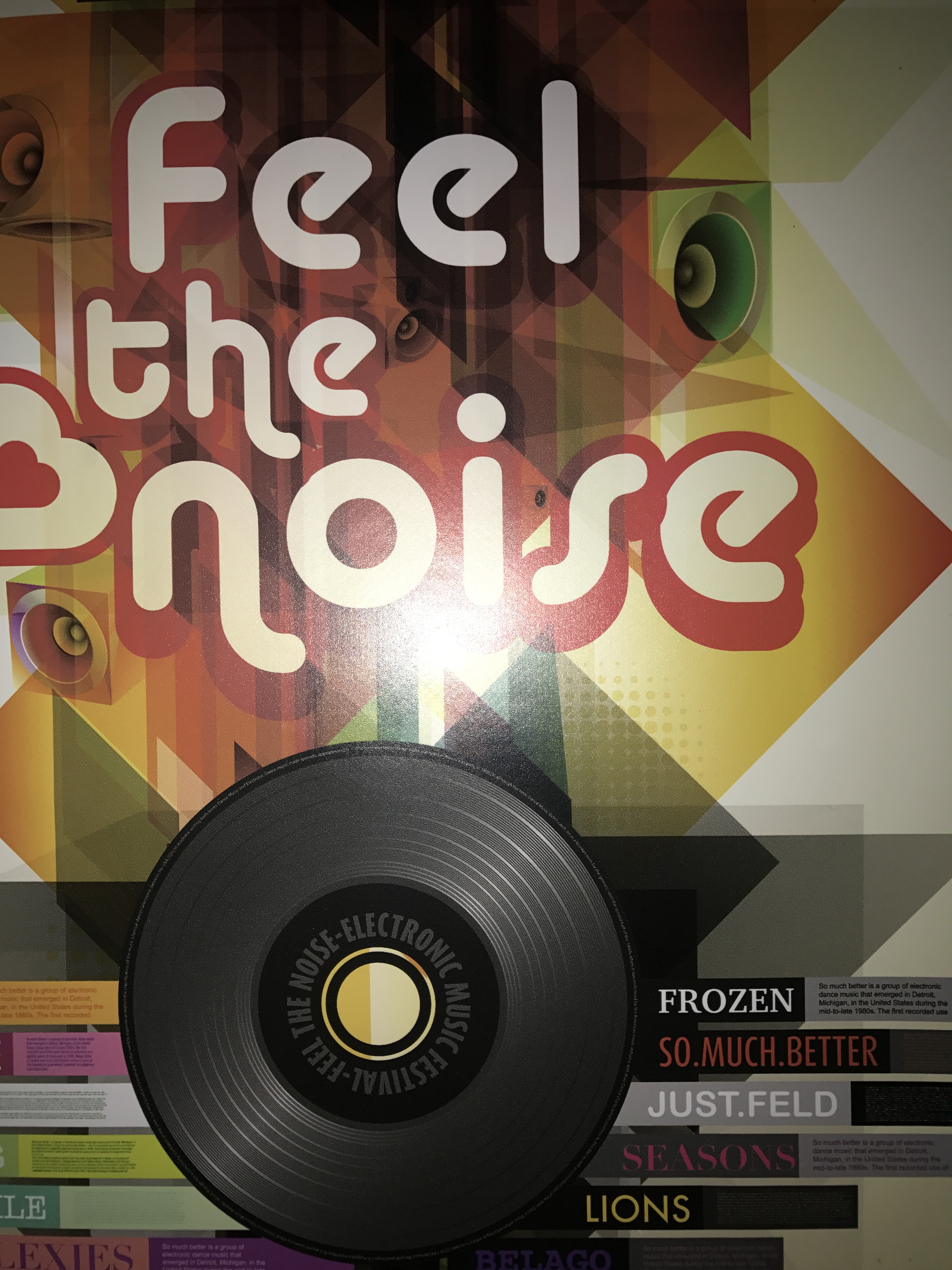

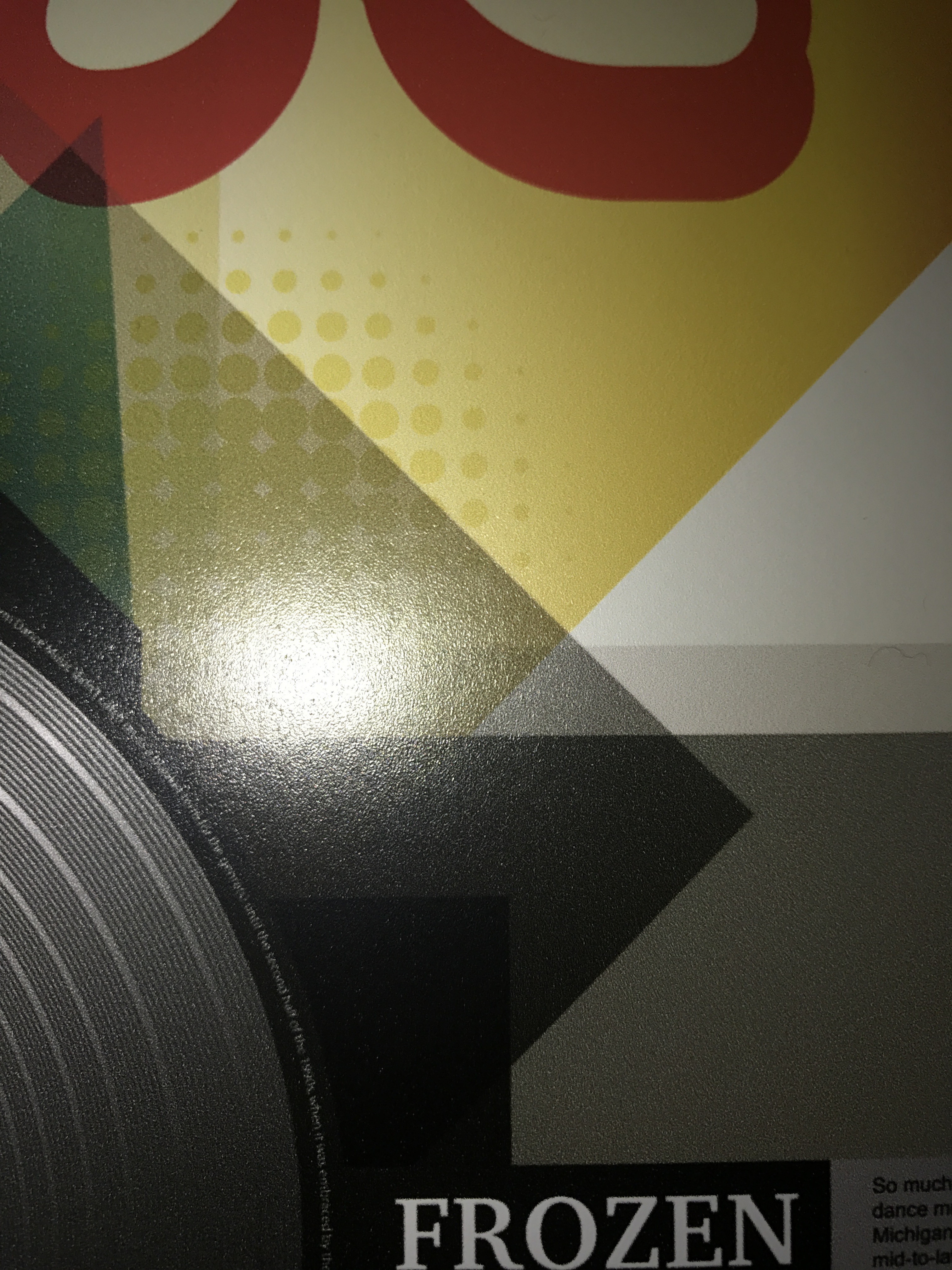

I currently do t-shirt transfers using inkjet paper (terrible..but it's been paying the bills). I have some questions and concerns before I decide to upgrade to the Latex 115 system. I'd really appreciate if anyone can help me with this:
1. All of these posts about "grainy prints". I ordered samples from HP and they came in yesterday. The prints had some grain but nothing near as bad as I thought. Attached are some pics. First one is from 12 inches away and the second is from 3 inches away...my iPhone is exaggerating the grain a bit. If I were to download the profile from HP (it is available from printos.com) for the heat transfer vinyl that I will be using, is this the quality I should expect? Or do I have to jump through some hoops to get them to look the same? I am perfectly happy with this quality.

The graininess is mainly on solid colors. Anything coming directly for hp will be with perfect settings and conditions... Keep that in mind.
I've never got a complaint about graininess... You can see its there from an inch away, but not on most stuff. I like it better than solvents which had graininess and banding. Not everyone can see the banding...but even on perfect prints I can tell when the next pass.is on solvent. It's Not as noticeable.. But still there.

Grainy prints results often from wrong feed adjustment. While this would be no problem with the OMAS-machines (except with some media), the machines without OMAS (110/115, 310, 330) can run into that problem easily (this machines needs to be calibrated manually). While a lot of printers get banding if the feed isn‘t correctly adjusted, the HP will have grainy prints and blurred borders on printed graphics in media feed direction.
