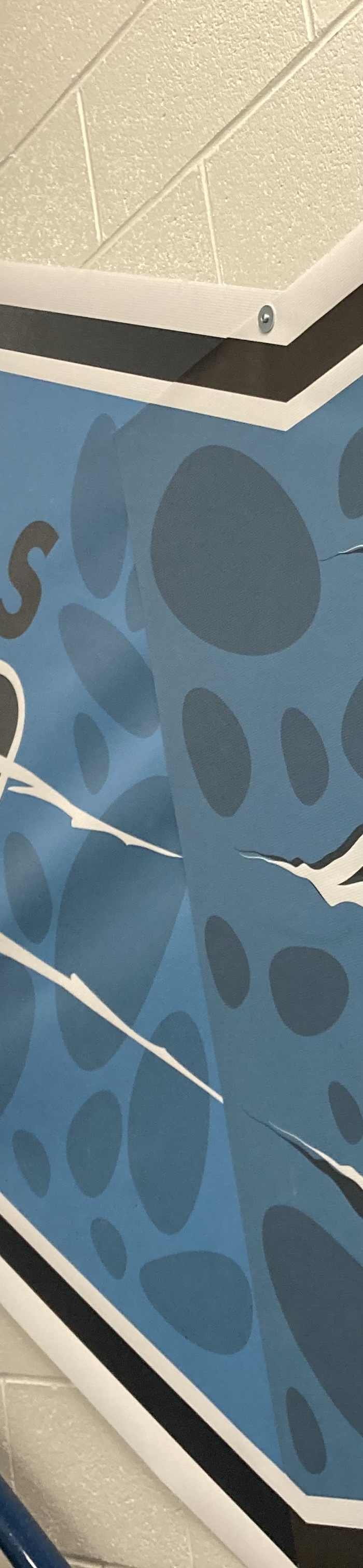

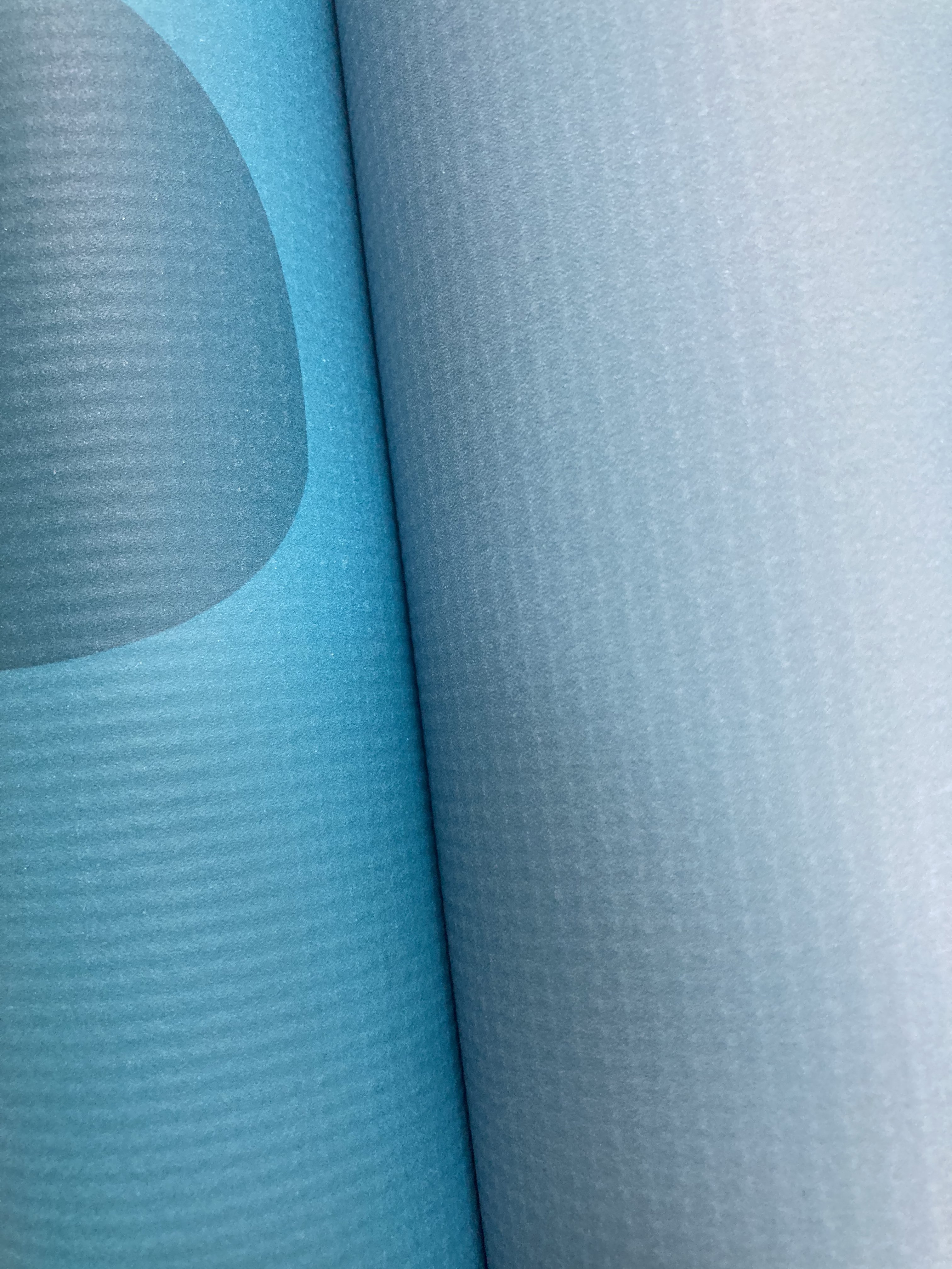

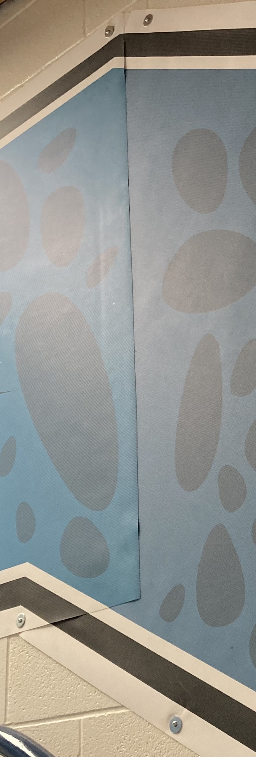

I just printed three vector files on a Roland TRUVIS 540 and all three are the same colours from illustrator but when i print them all three banners are different blues. Using pre-press and banner profile. Can anybody help me out why every time they print I get a different blue. I have printed them out 3 times and I have yet to get three blues the same. If they were stand alone banners it wouldn’t be such a problem but they go next to each other and you really see the colour difference. Can anyone help?

dom
I replaced my ink pouches and did a job before this three piece. Can anyone help with how you print three similar banners with the same blues. Tried raising heat and dryer no change.

Thank you for all your responses. I tried several methods and tried printing it three more times. I moved and placed connecting parts of the 3 files together and did a clipping mask and it printed a similar blue ( a slight gradient over 18" I used 6" from each file.
My solution was to redesign it as one long banner with crop marks for where they were going to overlap and gave myself 3" overlap. The blue did nor print the same for the duration of the print. There is a slight gradient to the blues of banner when you look at it but now it is way closer now than the other 10 prints.
