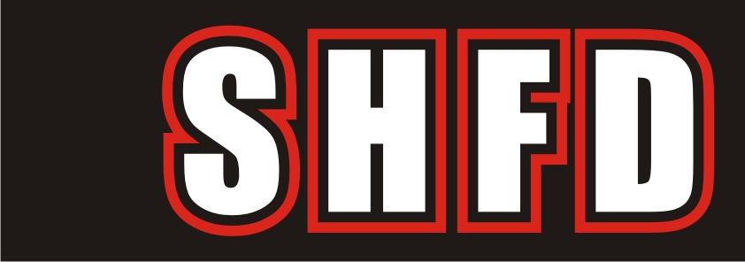

Do you mean so it would look like this if used on a black shirt for example?

Yes. That's what I had in mind. However, they need a little thinner contour line and if possible, between the H and the S gaps like you did with the F. I do appreciate your help.
OK what you need to do is to add two contours, then ungroup them. You can then select the two contours and combine them into one object. This will leave you with the text, a gap, and then the contour as a separate object.
Also before doing a contour, convert the text to curves as this will give a better result
