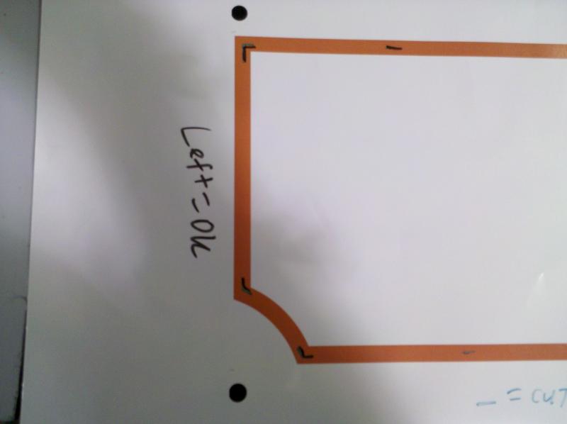

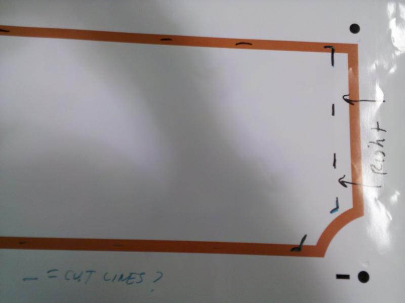

Anyway, when I send cut job via flexi pro to SP300V, for some reason it starts cutting perfectly on the left side of the image and then the cut is off about 1 inch or so on the right. See pics.
The entire image is about 1 foot by 2 feet.
Also, when I made the image smaller, say 5", it cut perfect on the SP300V?
Thanks for any help anyone may have on this one?

Did yo do the print & cut and the cut adjust to your SP???
If don't it could be the problem, for doing these operation see you SP manual (you can download at roland oficial site)
TSG
are you removing the media to lam? or is it doing this in a hybrid job? One thing i found out is that when you go back to cut, make sure NOT to poll the media width again...If you do this, it will throw off the cut...Not sure if that helps you or not.
