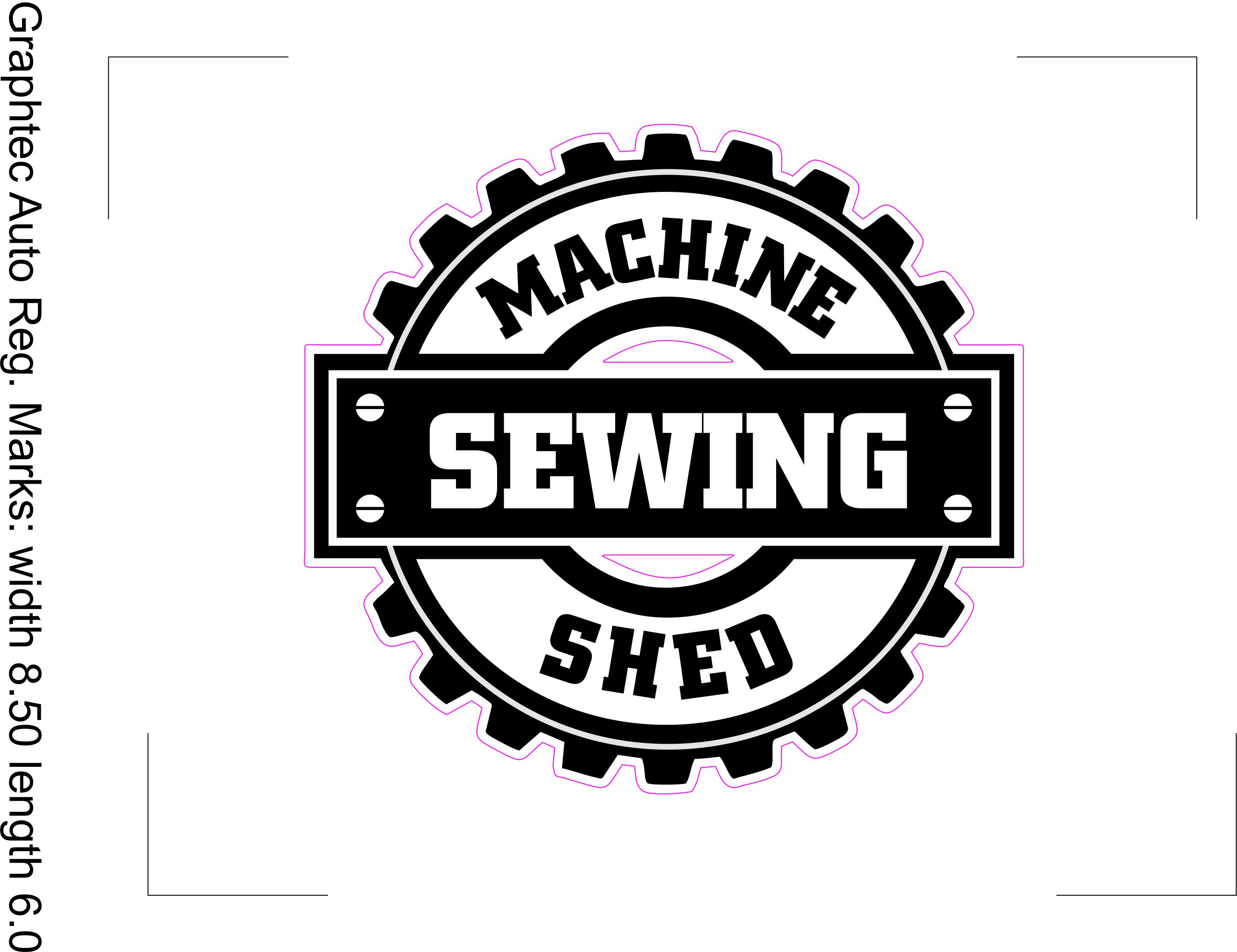

My marks look like this. Graphec CE 3000-60 MK2 Set the marks in your RIP.
