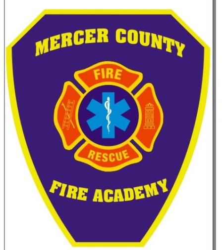

Made a graphic in Corel Draw and I have to export to a jpg but the color blue (which I have set in the cdr file as a dark navy blue) is coming up a very bright blue during the export.
I am exporting as a jpg and for the color mode in the setup before export I have set up for the highest (32 bit)
Any idea on how I can get the true blue colors in the export?

I should of also stated what version I am using:
Using Corel Draw X3
IN Export I set Color Mode to CMYK 32 Bit
Did not see any option to turn color profile on or off
Using the default CMYK Color Pallette with blue
Below is 2 graphics - 1 is a screen shot of what the actual graphic looks like in corel draw, the other is the export so you can see how the blue gets lighter. This is a patch I am designing for the fire academy where I teach and they wanted to see a proof before sending to the patch designer.

Williams Signs
export your design as a 24 bit rgb jpeg. I have found colors are always off when I export to 32 bit cmyk but are just fine when exported the other way. Most all jpegs are in rgb format.

captainron19
That was the trick - changed to rgb 24 bit and export looked exactly as it did in Corel
