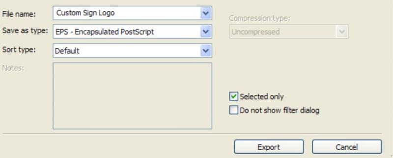

I use Corel X5 but I always have "Selected Only" checked. If nothing is selected then it will be blank. Hope that helps.
