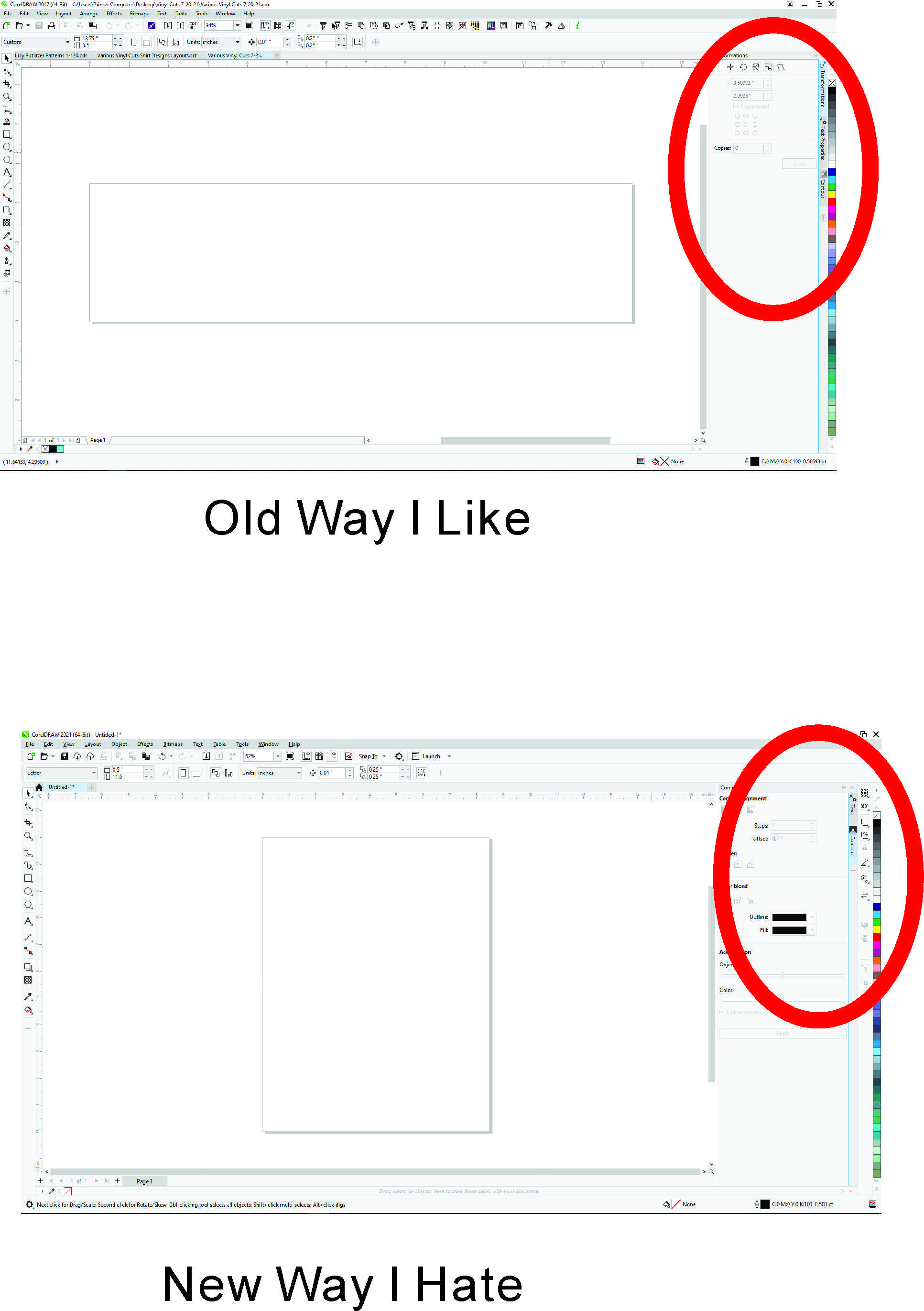

On previous versions I always had the transform toolbox on the right hand side along with my text toolbox and my contour toolbox. I use these all the time. On the Coreldraw 2021 it seems like they have really changed things. I can't seem to get the transformation toolbox above the other and then the options are terrible. You have to click flyouts to get to the options like size, rotations, step, mirror, etc. Does anyone know how to get it to look like the old way? I also have it to the right of the text and contour toolbox and they used to stack on top of each other.

Here is what the PDF is above in case.

When it originally opened it was in the middle of the page. I dragged it to the side and then it anchored itself there. Now I can't seem to pull it anywhere else.
I keep all the flyouts I use frequently anchored to the right side of the page. Much handier. But it you want to move it, just click and hold the tab of it and pull it off the edge of the page. Or to rearrange the tabs, click and drag up and down in the line and drop it where you want it.

I don't really see what's so different about CorelDRAW 2021 versus the past few versions when it comes to UI items like the Transformations palette. It's pretty easy to add other fly-out palettes to an existing one. There's a little "+" icon at the bottom of the palette tab label. Click that to bring up a flyout menu showing a long list of docker options. I usually have Transformations, Align & Distribute, Objects, Color and Properties nested together in one docker group. I can move that around the workspace, attach it to the right margin of the workspace or even pull it over to another monitor. The palettes can be re-arranged pretty easily or torn-off.
