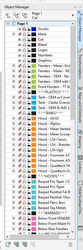

This is going to sound newbish: I have used Coreldraw for a long time and always had quick workarounds, but CorelDraw 2020 has changed so much from 16, I'm getting sick of dealing with crap disappearing.
I hope I can explain this; I use photoshop a lot and I understand layers, ect,
but I have no use for layers (not sure if that's the correct name) in Corel draw. When I switched to
CorelDraw about ten years ago, I switched from Inspire Sign graphics, where what you saw is what
you got & that's what I would really like to have again... I have always had issues with things showing correctly on my screen in normal or enhanced, but not printing correctly because stuff is out of page or layer order.
I do create multiple pages for my proofs, but drag stuff out of the bounding box and work on it there,
now in CD 2020 stuff outside of the bounding box appears and disappears when I switch from one page to the other... Is there a way to get rid of that?

Yes, corel has layers as most other programs. I rarely have a use for any more than one layer. Couple of things to note, and you may know already. As you select a shape you will see which layer it is on by the info at the bottom left of the workspace
also note that you have a "Desktop" layer. That refers to the space outside your page boundaries and is only relevant when multiple pages are used otherwise it's irrelevant.
So, if you have 1 page and you place a shape in that desktop area it still stays on layer 1 but as soon as you add another page that shape will automatically be assigned or get moved to the Desktop layer.

Corel seems to be changing and re-arranging existing features in the program just to make it look like they're doing more with each upgrade cycle. The changes they made to the Object Manager palette are no exception.
The new default behavior of keeping desktop objects on layer and page is annoying. I quickly disabled it.
