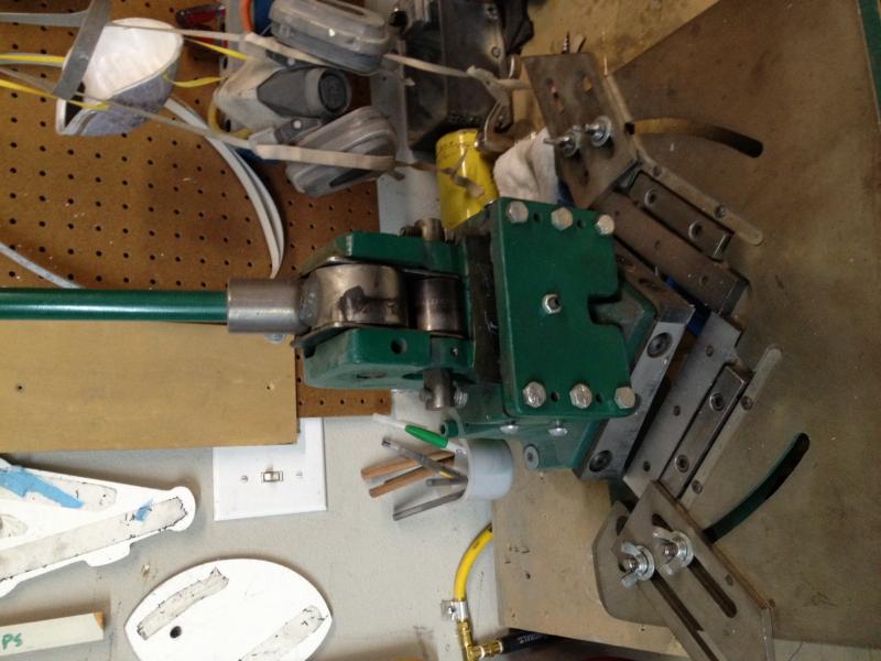

eahicks
This...cuts up to 6" notches....
Yes we have cool tools.
EDIT: Just re-read....you were asking about rounded notches....my bad.
