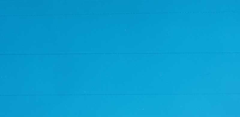

Now that that's out of the way, which adjustment is used to fix this? It looks like the feed is coming up short one line and it is overlapping the print by one dots worth, hence the single dark line. I have the service manual and I assume this is addressed by the Grit Compensation function but it's a bit confusing as to how.
See attached pic.

Grit Compensation is the way to do that job. But I can't explain it better how to do it as in the manual.
By the way: you will not be able to avoid any kind of banding like that. One Problem of the PC60 is that it only uses stepper motors, which can't be driven as exact as servo motors. And if the machines are old and worn out (and even the newest PC60 is now around 13 - 15 years old) it will be more and more difficult.
