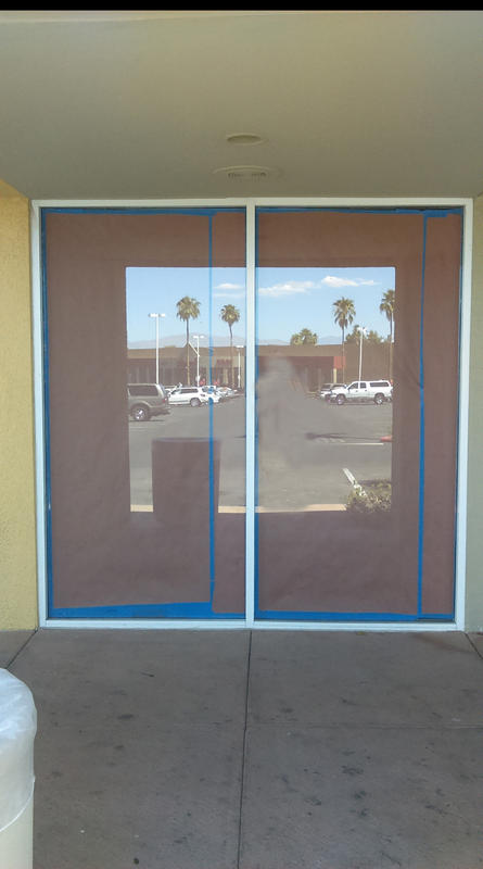

Went to the job after posting the thread and there is an overhang built into the building, so all the windows (North facing) are set back in the shade somewhat. Went at the hottest part of the day (1-ish) and the sun is already behind the building. Hanging the sheets without warping is my main concern at this point from weight or heat. I'm going to take a temp reading on the glass tomorrow while measuring.
The photo is typical of all the windows.
