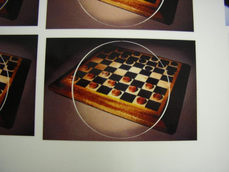

Just thought I would warn anyone about using Avery MPI3100. I bought a roll of this on sale a while ago, it was $50 a roll less than my usual Oracal 3651 that I normally use for my "go to" economy vinyl.
I had to print and cut some 2" decals, so I laminated them and cut them out. I forgot to turn off the heater on my roland for the cut and when I came back the vinyl had shrunk about 1/8" all around the decal! this has never happened with my 3651!
Looks like i will use the rest of this roll for strictly coroplast signs!

Watson, how long did you wait between printing and cutting? This looks like retained solvents in the film have caused the shrinkage after cutting. You should allow 24hrs between printing a profile cutting.
Christian @ 2CT Media
So you basically admitted to over heating the vinyl, almost any vinyl will shrink on a liner if you leave the heat on it too long then shut it off. I'm not defending Avery, Not a huge fan of their offerings but I don't their material is to blame.
