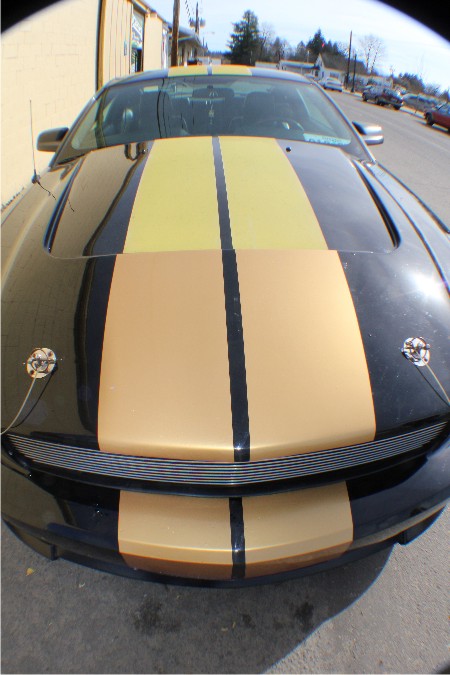

This is crazy. I have to restripe a Shelby GT Hertz edition...and you can see the new stripes I'm laying on the front (Oracal 751), and what the Oracal looks like after 5 years on the rest of the car. Talk about fading!!! Wish I knew what grade of vinyl Shelby used, but I'm betting it wasn't 751. I am 100% sure it's Oracal gold they used, just don't know the grade...

I do paint stripe kits for their new gt350's in vagas and they sent me a decal kit they were using before deciding to paint them on and it was Oracal 651!!!. It looks like a cheap gold on the car. Hel lmaybe it's SHINERITE ha ha.. Thats what the cheapo shops around here would do.

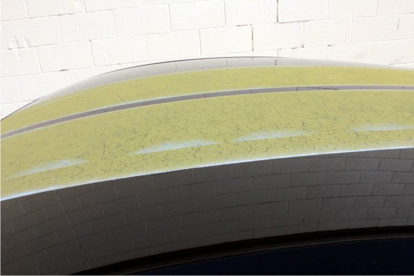

Which means in my book that at 4 years 11 months it should still be about the same color as it was originally (close enough anyways). Not like....this.

do you think they used some kind of wax or cleaner on the car that did this( over Time). It kinda seems like maybe a chemical along with the sun did this.

Metallic vinyl - black car - horizontal surface - 5 years later - seems about right.
Similar set up here would be too hot to touch around lunch time just about every day.

Yeah I am not posting this here to diss on Oracal. Just sharing an interesting project I'm working on. One of the worst crack/fade jobs I've seen (here in the NW we don't get the sun like some of you southern guys do).

I do a lot of car stripes and I make sure my customers know that vinyl that is rated for 6-7 years will not last that long on a horizontal surface, period. I tell them all that the most they can expect is 4-5 years. If the car is driven daily and kept outside (here in the south Florida sun especially) it may even be less.
