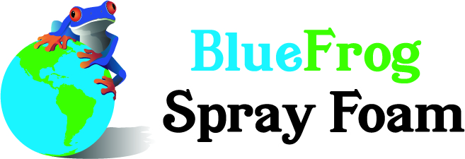

Hi. Here is a logo I've used for client. He'd now like to make a 3D version of it. I was thinking out of styrofoam, or clay? Or.........???? Anyone know of anyone who does this kind of work? Thanks in advance!

Hi Joe. I'm thinking actual 3D. So the world would be a "ball" and the frog would be, well, a frog! Haha. Im thinking the world to be about the size of a basketball. Any ideas?
mrchips
Get a rubber ball from a toy department.....cut in half and fill the back with cheap insulation foam......sand flush and paint? That's one idea.......HDU turned on a lathe.....that's 2. :)
4R Graphics
If you want it to be a raised style carving that is say 2" high and flat on the back then anyone with a CNC Router and 2.5 D software can do it.
If you want a true 3d statue type carving then you will need a full 360 degree model of the logo and then anyone with a cnc router and the right software (most pros have the software) can slice the model up and carve it in sections/layers which are then glued together and finished (clean up edges and paint) some may have a rotoary axis that could do it from a solid block but that type of machine is limited to expensive systems especially something the size of a baskestball or bigger.
Most anyone who has a cnc router and the right 3d CAD/CAM software can make it in layers (which is the most common way).
The modeling is the hardest part.
I would check the local college for someone that could model it for you at a reasonable price or class project and then find someone to do the cnc work.
I have owned a cnc router and have done several projects like you are talking about in the past.
I donot have a cnc router at the moment but will by the end of the year (maybe summer time) and will be offering my services to the forum as a merchant member once again.
Good luck with your project.

Anyone with a CNC router and 2.5D software could make that for you very easy.

sardocs
Dave - I sent you a pm - If you need help with this give me a call. My phone number is in the pm. You really don't need a CNC to do this job. I'm pretty sure I've got enough HDU scraps you can use to put this together. I'm just up the road from you in Pender Harbour.
