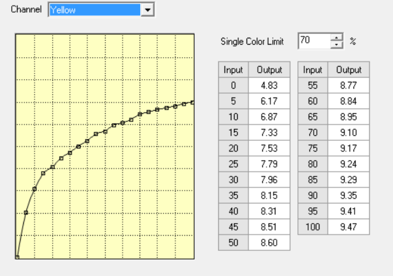

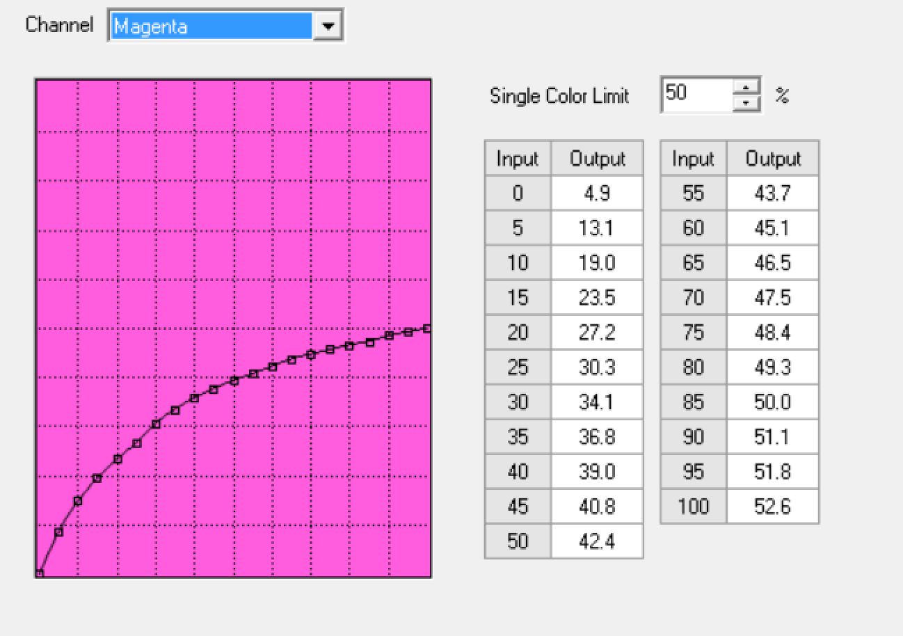

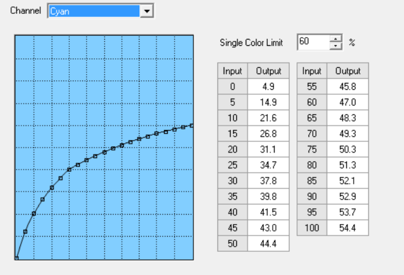

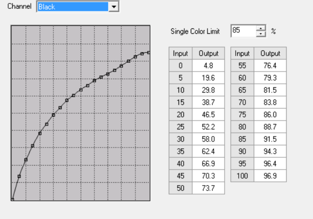

Please see attached my dot plot, what do you think?
