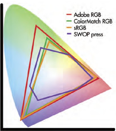

I'm not going to argue with anyone who has a system that works for them. But from what I have read in every Industry mag and book I have ever read has always said to design in rgb. The loss of color gamut is to large otherwise.
Design to look pretty on screen without the intention of printing anything out is definitely better in RGB however if you plan to print it, CMYK tends to give a closer result.
