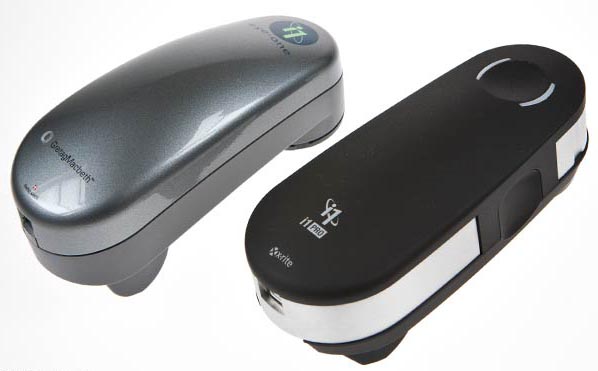

Is this an i1Pro device or an i1Pro2 unit? See attached image if not sure.
Either model is compatible with Windows 8, and the OS drivers load with i1Profiler software, which I am assuming that you used to profile the display with, correct?

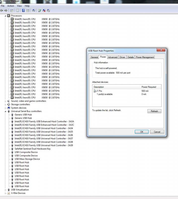

It is also quite possible that there is just some other issue related to drivers. One thing to also note is the i1 draws a good bit of USB power. It is best to not plug it into an extension cable nor a front USB port. Best is one of the USB ports directly on the computers motherboard on the rear and preferable to not have it sharing the "usb hub" with any other devices which might mean switching other USB devices around.

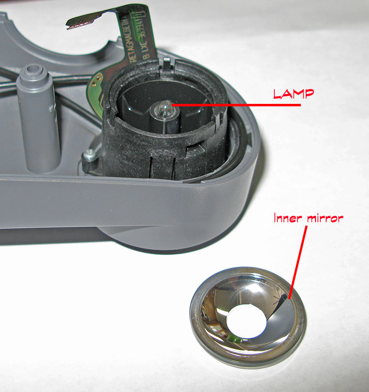

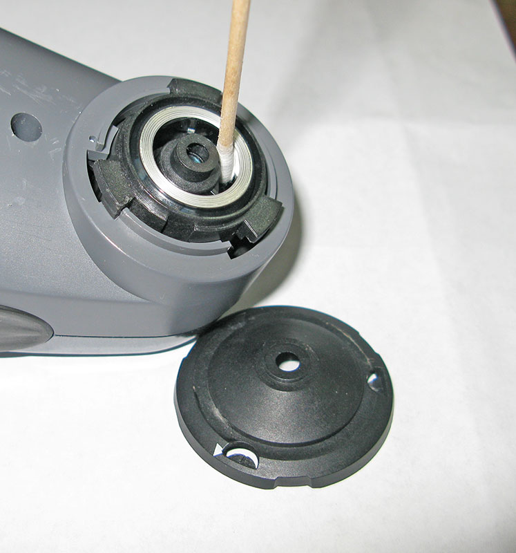

First and foremost - I bear no responsibility if you damage your device. On the original i1 device you can remove the main aperture cover by rotating it to the RIGHT about 3/16 of an inch. This cover has a glass lens which you can clean. Once removed you can then also see the inner center lens and the silver ring around it. The inner side of that silver ring is a mirror surface. At one point my i1 was failing one of the diagnostics (I think it was one of the reflectance tests). Being adventurous I dug in and I noticed on mine that the lenses and the mirror had become slightly dirty over time. It is a very tight squeeze to get a swab in there as shown. I used one moistened with 99% isopropyl alcohol. The outer mirror has a divider - you have 3 sections to clean. You can clean the outer mirror, the inner lens as well as the lens on the cover part. If you are feeling really adventurous you can remove the 3 screws on the bottom (breaking the warranty seal), remove the upper cover and from there you can clean the top of the actual lamp as well as the upper mirror. That gets delicate - you can very carefully remove the upper mirror by very very gently (I imagine breaking one would be near catastrophic) releasing the 3 clips. I have not attempted to go any further than this although I imagine you could remove the senor module (in the white foam block with the fiber optic line to it and the mirror/lamp assembly and break things down even further. I have no idea on the exact specs for the lamp (and I doubt Gretag will give you that) so I think trying to source and replace the lamp yourself is probably not viable without knowing the specific color temperature, composition, size, and wattage/voltage of the bulb. You can also just contact Gretag and for a fee you can ship the device off to them to be re-lamped. I forget how much that costs but I think it is a couple hundred bucks.
Anyways after cleaning mine passes its diagnostics perfectly. I strongly recommend against doing this unless your device is long past its warranty, has a few years of age on it, is failing the diagnostics, and you are not terribly worried if you happen to make it even worse....

And AF is correct it that it can be finicky about the USB port it is on. The lamp in them draws a good bit of power and it works best if it is not on a shared port. By shared I mean your PC probably has 2 or 3 USB controllers, each of which is tied to one or two of the USB ports on the computer (front or rear). The computer will not indicate which ports are shared with another on a controller. It is best though to use a rear USB port - if you want to get adventurous you can look in Windows Device Manager to see what is on a controller with another device. Each controller will have a Hub which will be for two or more physical USB ports. Look under Universal Serial Bus Controllers then double click each Root Hub, then click the Power tab. From there you can see what is connected to a particular controllers hub. It will take trial and error to move USB connections around to isolate it. Attached shows mine on a controller hub by itself. On my workstation - it does not work properly on one of the front ports (even though it is still not on a shared hub), I think because the front ports are not capable of providing as much power as the ports directly on the motherboard.

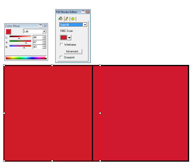

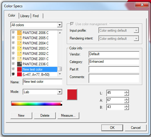

I know a LOT of people on this site simply hate FlexiSign. That being said - I think the majority of those have never really dug into it's depths and got it configured just right. Flexi uses the APPE as it's RIP engine (they actually license the Adobe PDF Print Engine) so its no real surprise that Flexi really prints best with RGB files, specifically RGB files with the Adobe RGB profile assigned to them. Most RIPs charge you extra for every little thing. Flexi has full support for an i1 and profiling built in, color measuring is built in, supporting multiple printers and cutters is built in, etc.
