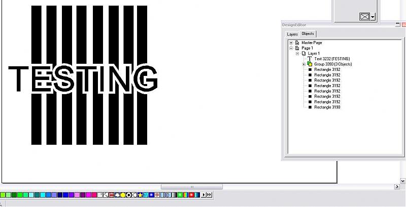

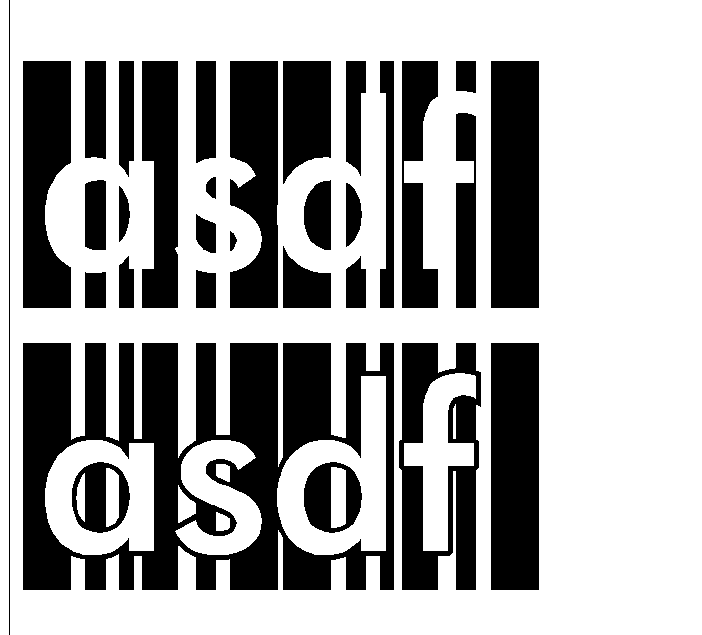

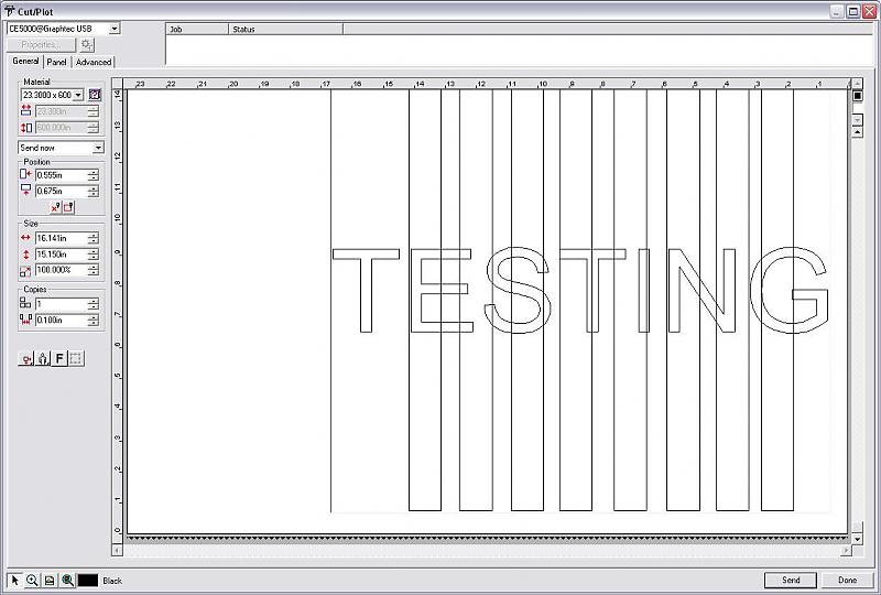

ok BASICALLY.... what I have is a barcode image. Black stripes going down. Inside of the barcode I am trying to put text. But I want the text outlined so when I go to weed, the letters are still there, but only the outline sections and the parts of the barcode that shouldnt be there are taken out.... But for some reason I keep getting it backwards... the outline stays, and the middle portion of the text is removed.... What am I doing wrong?!

Tried that.. but it still wants to cut the bar code, THEN cut the text, THEN cut the outline so I keep getting cuts through the text

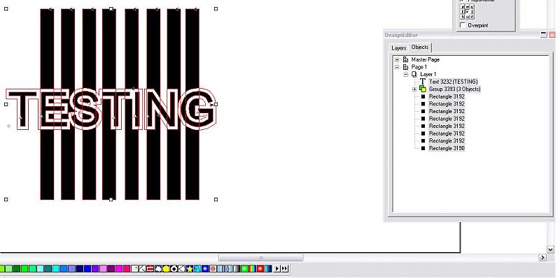

Sounds like you need to do a "cut out" from the bar code.
I assume you need something like this?
edit: Just saw your picture.
1) seperate the white outline from the black text.
2) "Cutout" the white outline object from the barcode
3) send to cut.

don't understand what you need. But to avoid cuts through the text, group the outline and barcode only, not the text and hit weld.
