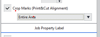

So, in Versaworks 6 (and possibly before), there is an option to apply Print-Cut alignment crop marks either for each row, or for each data entry. I've tried playing with the setting, but it always seems unselectable. I've tried using it on nested jobs as well as multiple copies. Does this actually do anything, and, if so, under what conditions would you suggest using it?
Thanks!
Phae

Been a while since we had our Roland but I think we made the roll length the same (or slightly longer) than each row of the job. It would then put a fresh set of marks around each row as it went down the page.
