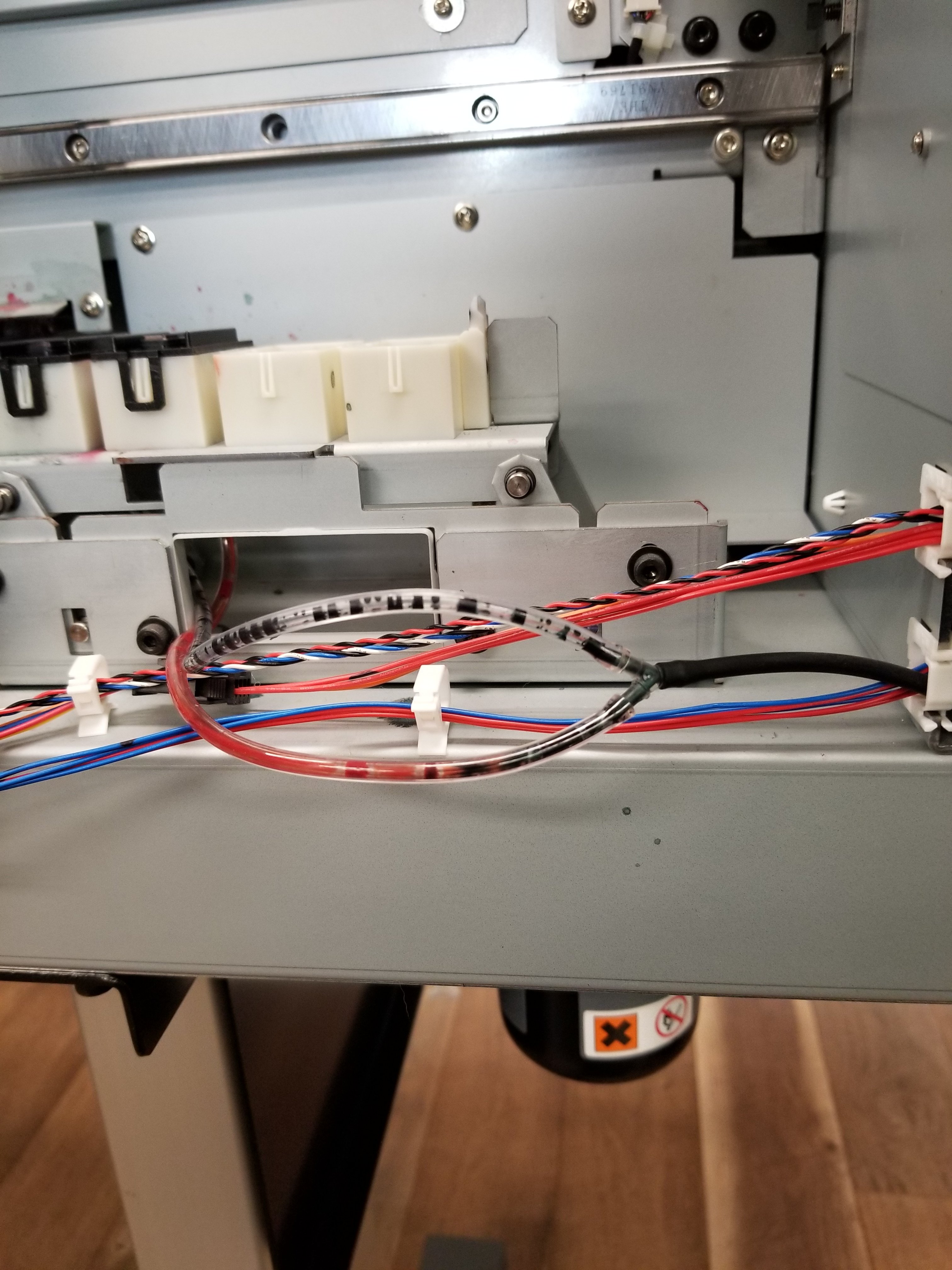

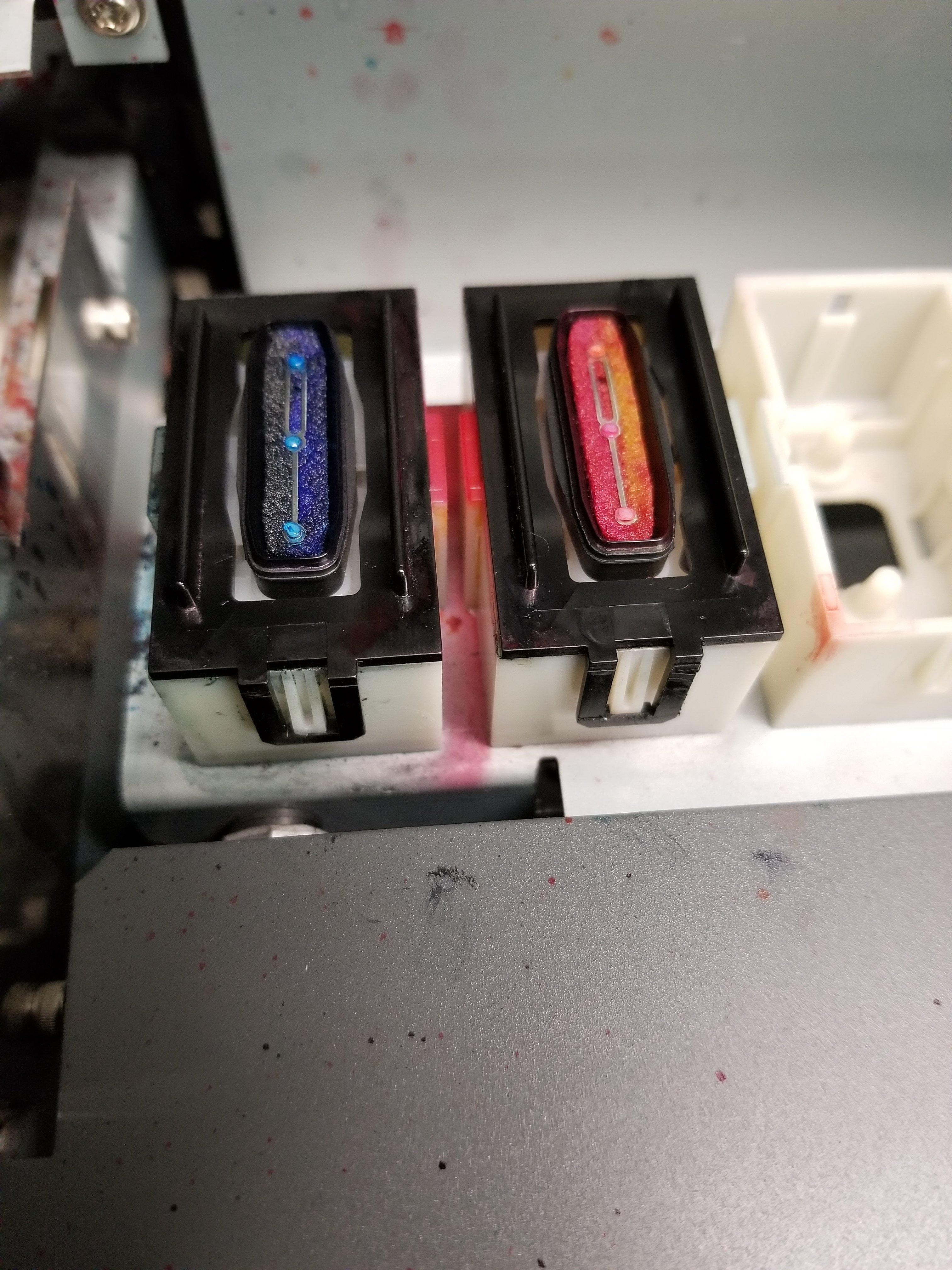

So I've been having issues for some time now and I just replaced both captops and am STILL having this issue.

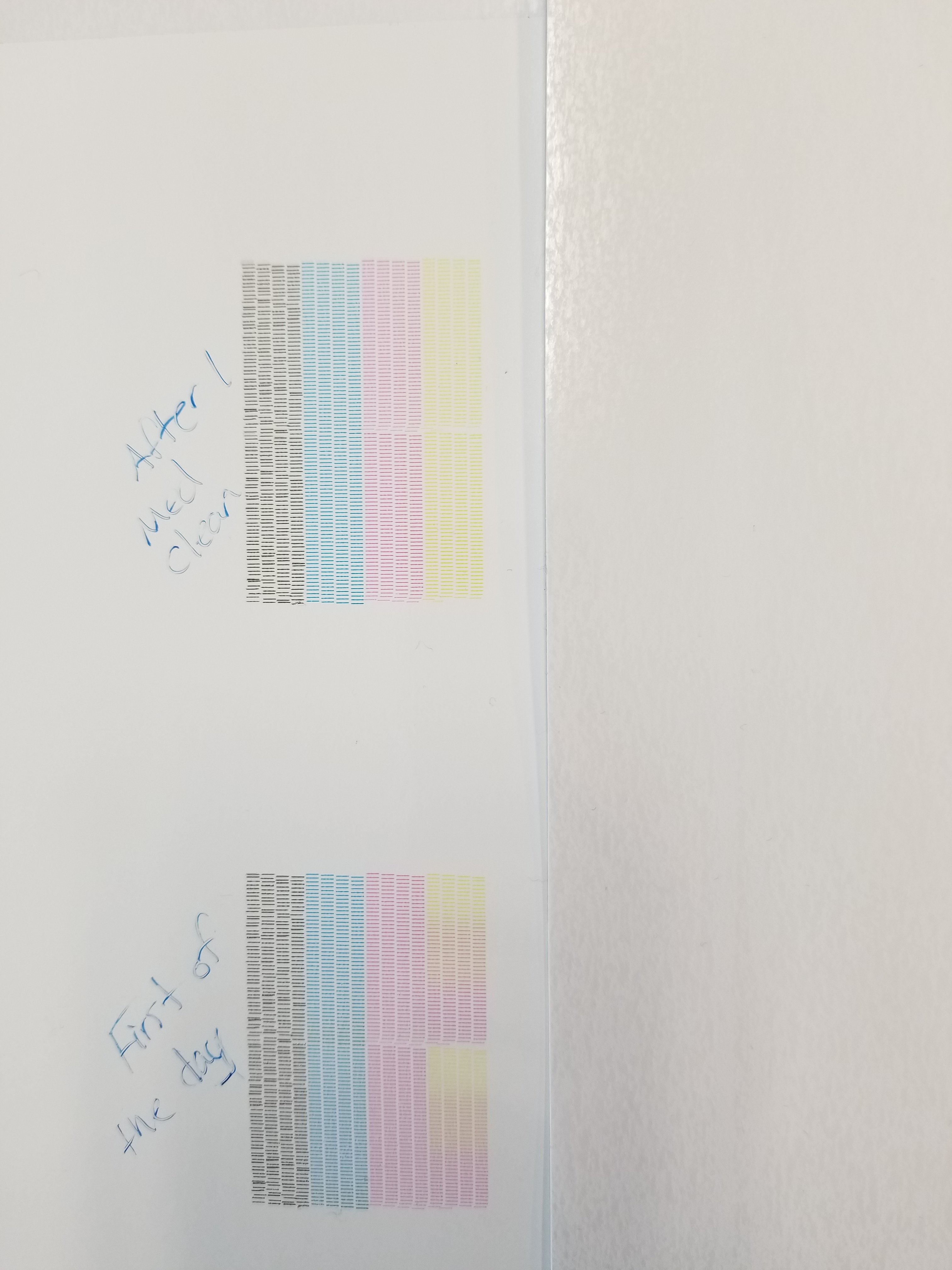

Problem started by me coming in my shop in the morning, Printing the first job of the day and seeing that yellows come out orange, blue's look pink etc until you get about 2 feet printed then it clears itself up.
Yesterday I changed the cap tops and lines to the Y fitting. As you can see, When I came in today and did a test print there was alot of contamination. I did 1 medium cleaning and it cleared it up.
What is going on with this thing guys? Another issue is that white line to the right of the test prints but I think that's a feed calibration adjustment.
Dampers were replaced less than a year ago with a new black head. (Yeah I know it's looking bad again hence my black banding :/)
Cap tops replaced the other day
100% OEM Inks used
Thank you in advance!

There are 2 print heads and 2 dampers per head making it a total of 4 dampers. I usually order 5 dampers as a back-up if I don't have spares around on site.
I would consider replacing both the heads if you are getting bad prints cause it shows you had a head strike on your MY head and your black is deflecting pretty bad.
You shouldn't have to do any alignments if you just do a damper swap but if you swap the heads you will need to do a manual and then menu alignment.
Make sure to charge your dampers with ink or you will get ink starvation if you just pop them on and try to do some medium or strong cleans.

When replacing the dampers, the following is important:
Pull them carefully vertically upwarts from the connectors at the printheads manifold, because otherwise the connectors could break. Put the new ones carefully back in place.
The ink will move back through the ink tubes. The most secure way to pull it back and fill the dampers is with a syringe at the tube of the capping when assembled.

So I came in this morning, filled cap tops with fluid and the magenta and yellow drained immediately and the black and cyan cap did not at all.
I took the Y connector off and pushed fluid through it to make sure no blockages.
Same story with this thing, You do 1 medium cleaning and the contamination is cleared up. Guess it's a work around but still pain in the neck.
