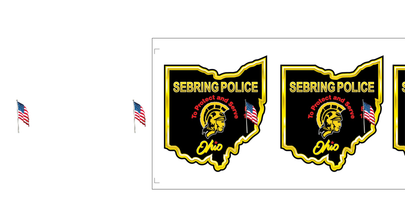

When reopened, any placed images, usually .jpg or .psd files, move out of their original placement as shown in the attached pics.
The first attachment is a recreation of a local Police Dept. uniform patch. The second attachment shows the flag images out of place.

Never heard of that happening. I did a quick google search and one instance popped up with no real solution.
Are the images embedded? If not, If you embed them then try re-opening the file do they still shift? The only thing I can think of is there were changes made to the flag image.
ddubia
I hadn't tried it before but I embedded the images and it then opened fine. I may have to do that going forward. Thanks for the idea.

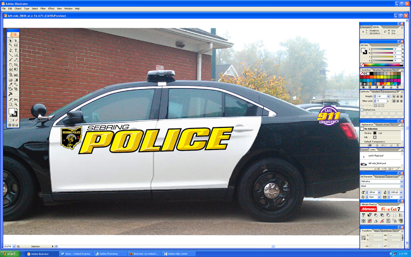

But the issue doesn't stop at dancing images.
The attached pic is of the sketch I did for a Police Car we just finished and delivered this past Friday. As you can see all the graphics have moved up vertically. All of the graphics are vector art which I made. The only image in all of this is the pic of the car and a small flag on the police patch shown in earlier pics. Astoundingly the flag didn't move as high vertically as everything else but it did reduce in size by more than 50%. :banghead:

I've seen that several times, but have never had the time to try and figure out the cause. Can't wait to see what you find!
