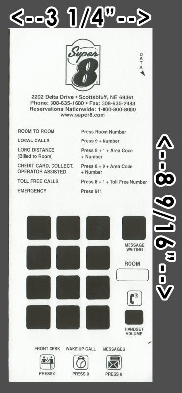

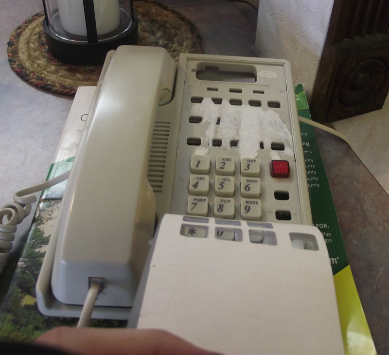

Hello Follow sign makers,
I am needing to find someone who can make me 75 of these 3 1/4" x 8 9/16" inserts. The go over a keypad so the black holes would have to be cut out. I would like them to be printed on some short of water proof material a 20mil plastic would be ideal! Any ideas on where i can get a quote from this would be awesome! View the attached image. They can be printed ether color or black and white.
Thanks!!

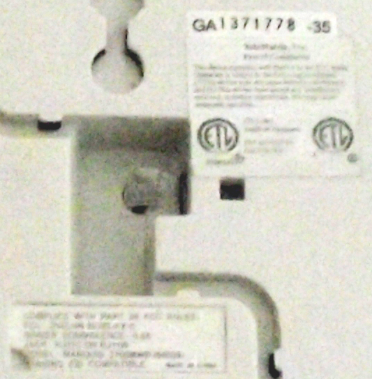

Spencer McMurtry
the only number i could find was GA 1371778 -35 (see attached image) is this the right number? Please advise where the number would be written.
Thanks!
