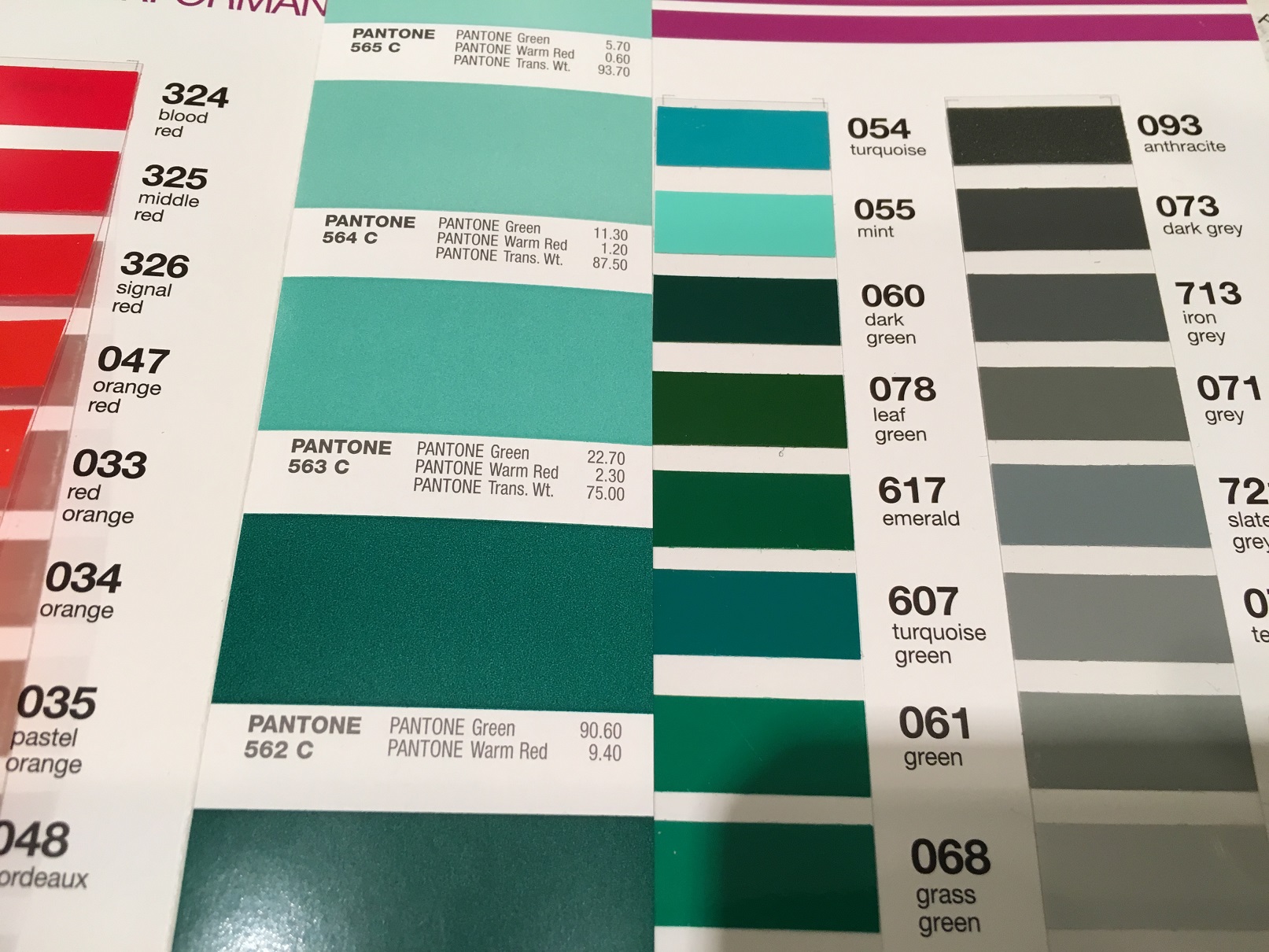

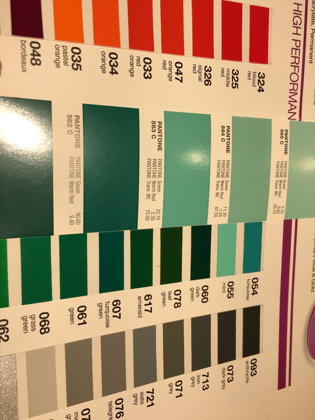

Well,
Its good that you posted the Pantone Color.(562 Coated) I have a 2017 Pantone book, Orafol and Gerber Colorcharts.
I think you would be happy with Oracal 751-607 Turqoise Green - Here are two pictures from my iphone - under two separate light conditions. (granted- I don't have an Avery or 3M swatch book to compare).
