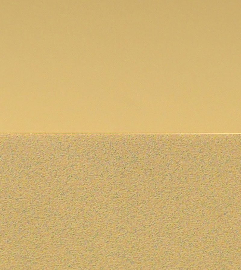

I've attached an image of 3M's full color 7725 vinyl (top) which is the color I'm trying to match, against my printed attempt (bottom). You can clearly see the dot pattern that looks like random overspray of cyan and magenta ink droplets. The second image just shows the 3M vinyl against 2 more swatches I printed.

I have an XC-540 like yours. The first thing I would recommend is if you're using canned profiles, try using Avery's profiles instead. They're the best I've found, even for printing on 3M or Oracal. Just try to match gloss with gloss, matte with matte, etc. Also change your default Colour Management to Sign & Display instead of Pre-press US or Density Control Only.
Now, I also have a 3M swatch book handy and I just compared it to my Roland colour chart printed on glossy cast, but nothing looks close to 3M Fawn, so that method isn't going to work. My suggestion would be to simply make up your own CMYK swatches in the colour range you're targeting and find the closest match with a bit of trial and error. The Blend tool in Illustrator can be very helpful for this—you can create two different colours and the Blend tool will fill in X number of steps in between them.
As for the ink "texture" on solid colours, that's a fact of life with CMYK printing. It gets better with more passes and higher resolution, but it also gets worse on certain colours, especially lighter ones. There's no such thing as a pre-mixed spot colour on your printer, as you suggested. Everything that comes out of your printer is a blend of cyan/magenta/yellow/black (and light magenta/light cyan). Versaworks does have a spot colour converter, but all that does it takes spot colours from your input file and splits them into CMYK.
